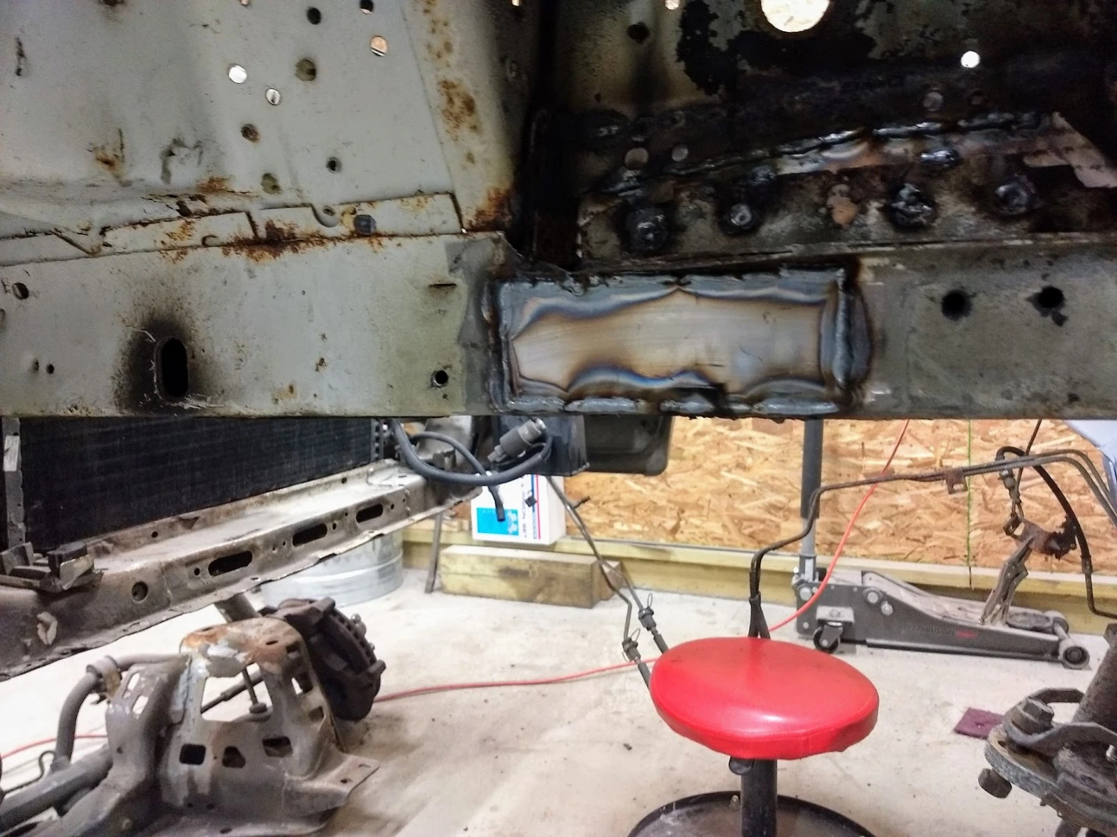

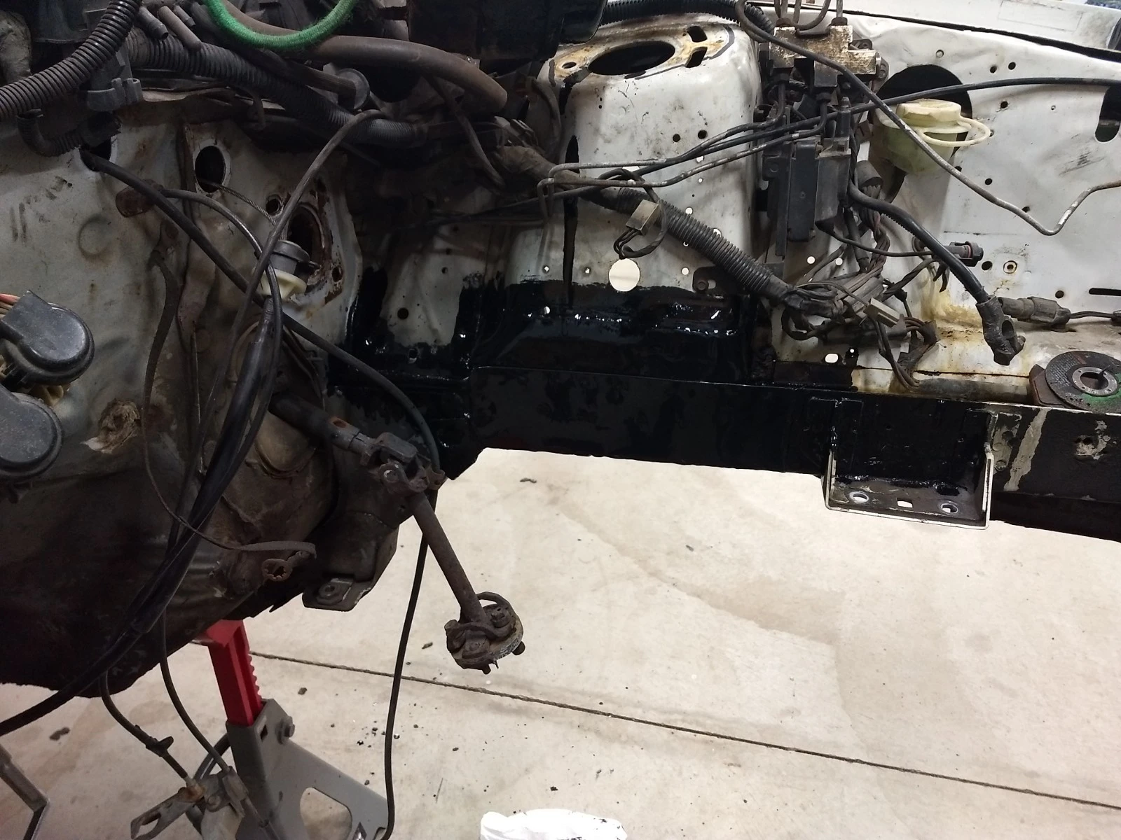

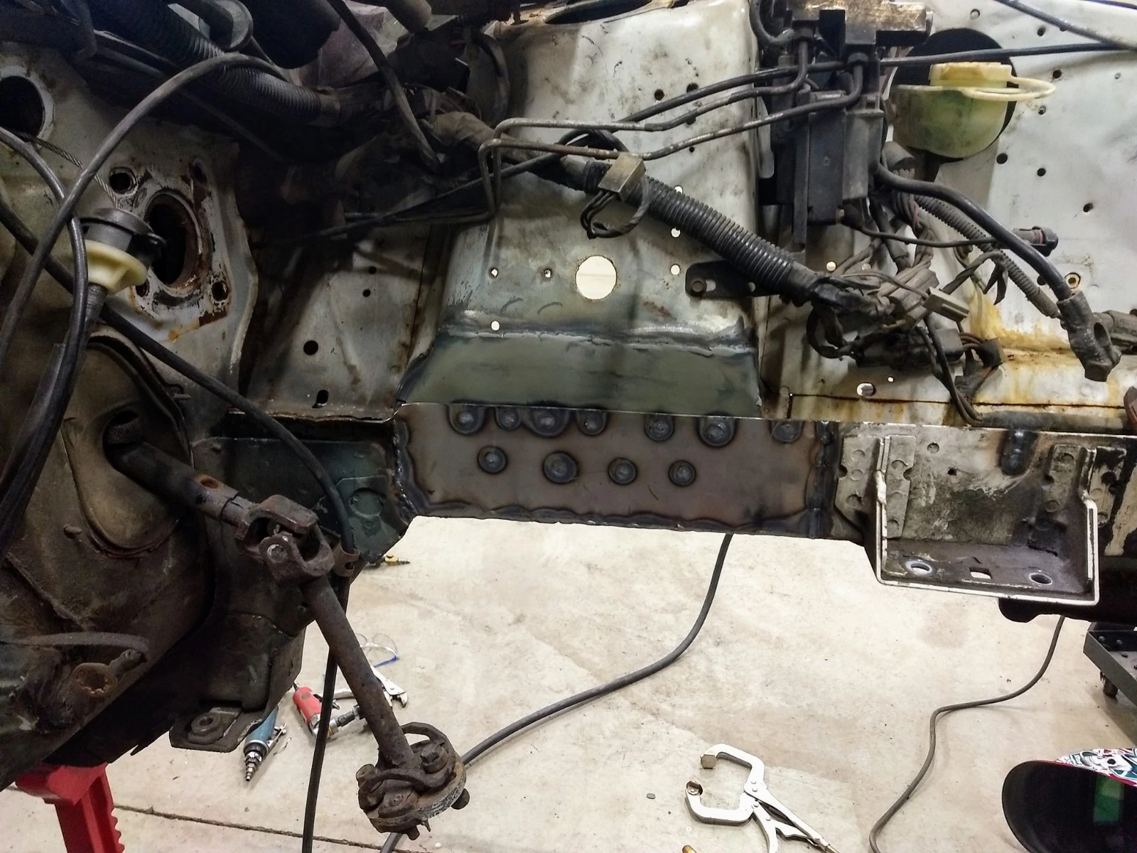

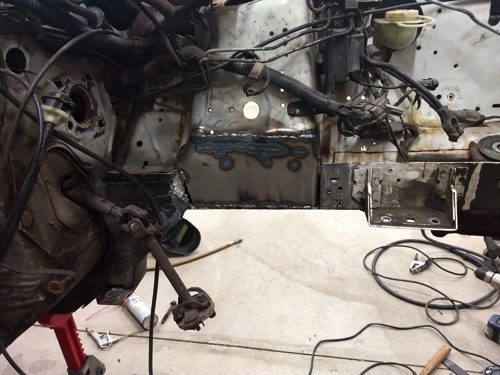

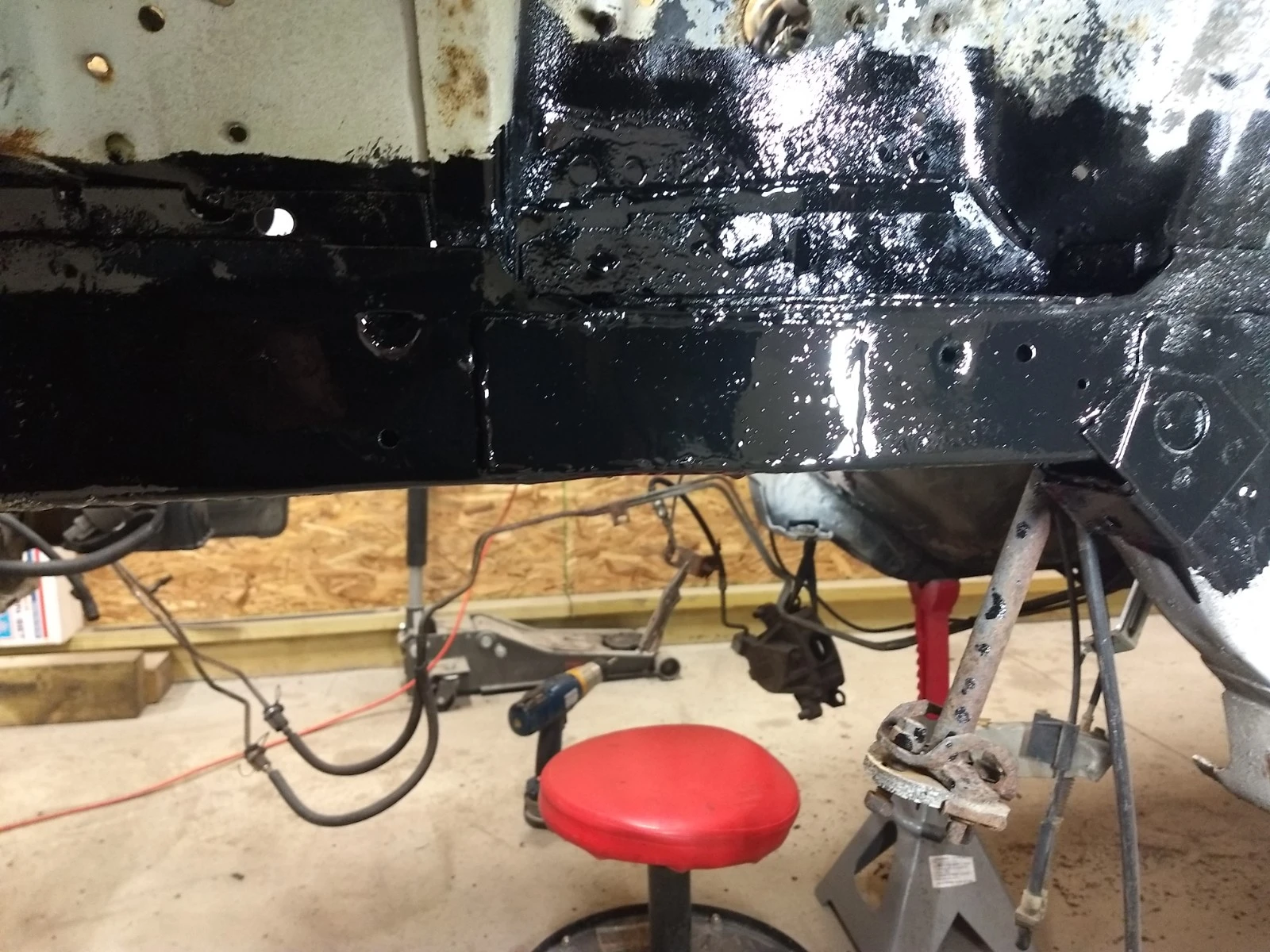

I painted inside the rail with Rust-Oleum before I welded the top cap back on, just no pics. When it's all done I have a rust proofing wand at work, it will be dripping from every hole there is.Nice work!!!!! but I noticed you didn't coat the inside with anything before you weld it up... when I did mine, I blasted it to bare, and used por15 inside.... then once it was all together, I used the Eastwood internal frame coating to coat all inside of the frame rails... and I did a lot of coats... don't want it rusting in there no more... in fact I've sprayed a s-ton of that stuff in all of the rails from front to back... and even re-coated it again this year... (figure I would do this every couple of years, just for insurance...)
hehe you said cavity waxHe should still be able to get some cavity wax in there through the holes Kendawg.

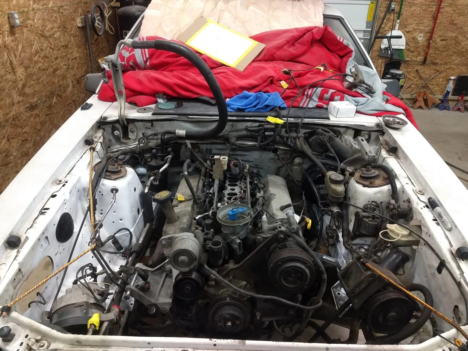

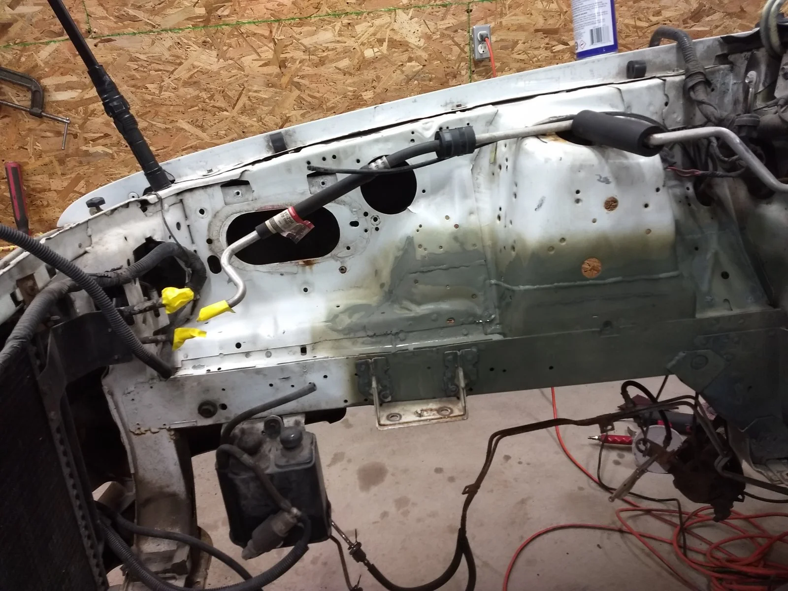

Time for another update, I've been working on the car here and there, but life keeps getting in the way. I got the K-member back in last week, I wanted to have the engine and transmission back in over the weekend, but nothing was going right, so it was time to walk away. I did manage to get everything ready though, I wanted to install a steel bearing retainer on the T5, the factory one had some wear on it, and I figure it would be a good upgrade, but when I went to swap it, the bearing race wouldn't fit. After some head scratching and some Google-fu I realized someone has swapped a 4 cylinder T5 into my car. After some more Googling and decoding the door trim tag, I now know that my car was originally an AOD car, oh well I'd rather have the T5. So for now the 4 banger trans is going back in as is, the 3:95 first gear should be a blast when I put the 3:73's in the rear. I will probably swap to a 99-04 v6 T5 later, I'll watch Pull-a-part for one, what really sucks is the car I cut the rails and strut towers out off had one, but it's been crushed.
Anyhow, I put the correct pilot bearing for the 4 cyl trans in the crank, installed the new flywheel and clutch, bolted the engine and tranny together, and had some time so I put it all back in the car tonight. I'm hoping to have it running and driving this weekend, then I can get back to bodywork.
