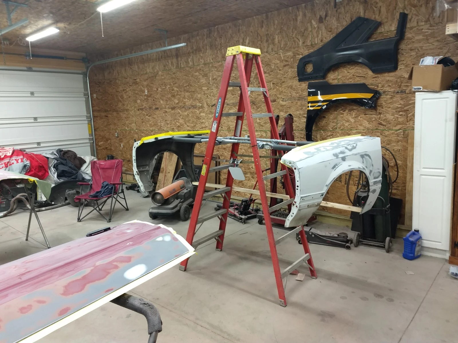

Update time, I've been side tracked with some other projects, but the Mustang is still moving forward. I'm not going to do a step by step, just an update and a big picture dump.
The day I started doing bodywork, I realized the doors were worse than I thought they were, a rust free set off doors popped up on Facebook, so I went and snagged them, I also got the front clip from the same car, I didn't really need it, but the guy said if I was taking the doors, I had to take it too. I had some fitment issues with the passenger door, it was sticking out about 1/4 inch from the cowl, I tried to fudge it, but ended up cutting the upper hinge off the door and welding it back on in the correct position. All of the bodywork is done, everything is in primer, and tonight I seam sealed the doors and cut them and the door jambs on the car in. I still need to remove the quarter glasses, hang the sheet metal back on, and prep the bumper covers.
I might try for paint this weekend, but I think that may be pushing it, I'm tired.
Pics.
I've learned so much from this thread, like the pic above mounting fenders on a ladder to work on them. Good to read that you're in primer now, huge step in the right direction.
No problem, I wish I was better at stopping to take pictures, usually I don't think about it until what ever I'm doing is already done. I only used the ladder to prime them, it's not sturdy enough to actually do work on.

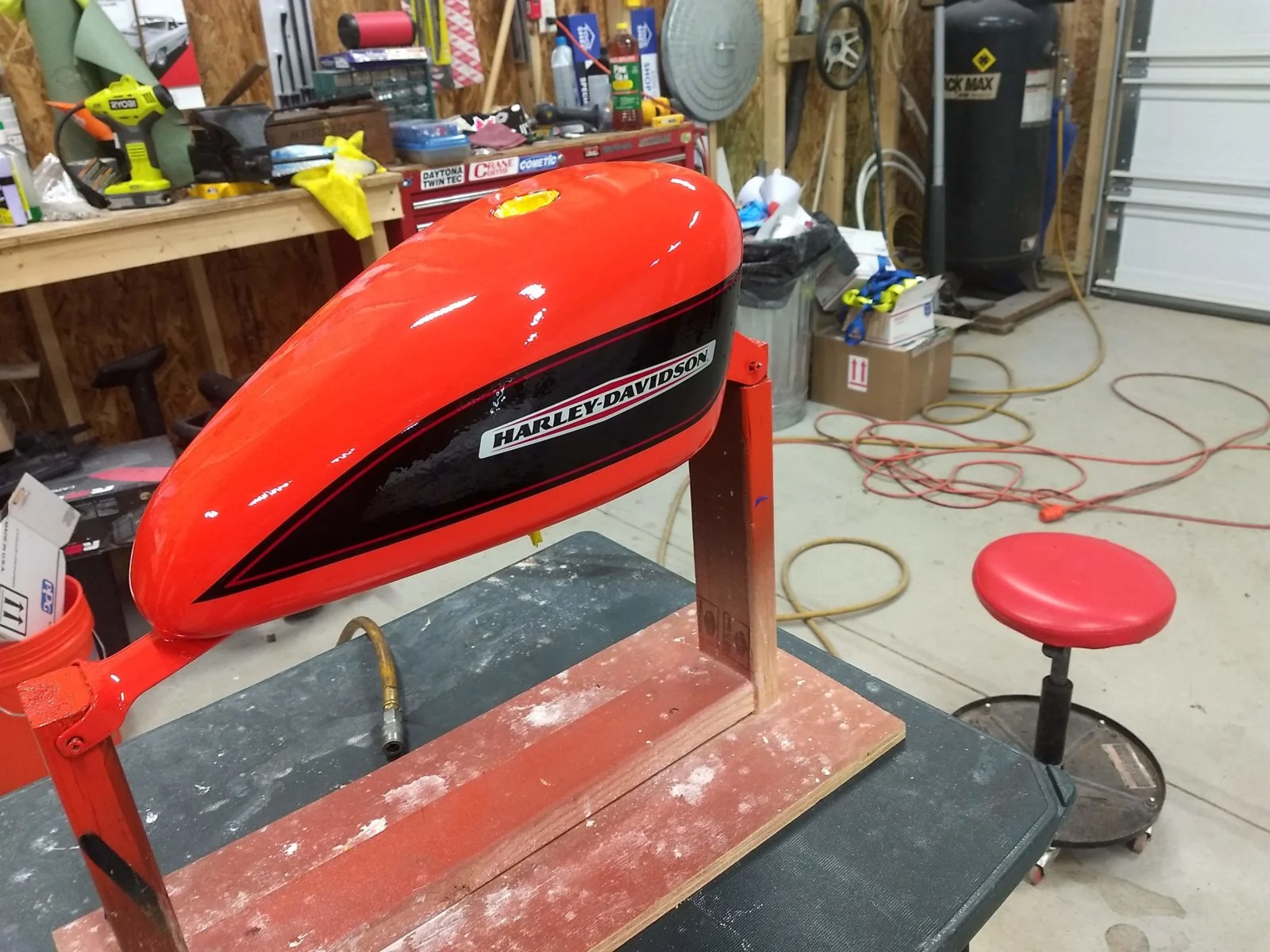

Essn95 said:
Did you use the HF gun to shoot the color coat as well? Heard good things about it and picked one up. 10 bucks on sale. Will be going to work with a 29 gallon compressor to start painting soon
I used one of those for the primer, I sprayed the paint with an old Devilbiss GTI.
I have used the purple gun for paint before, they work fine, like JustinL said, take it apart and clean it good, they are full of grease.

I used the purple gun for the clear coat on this tank.
