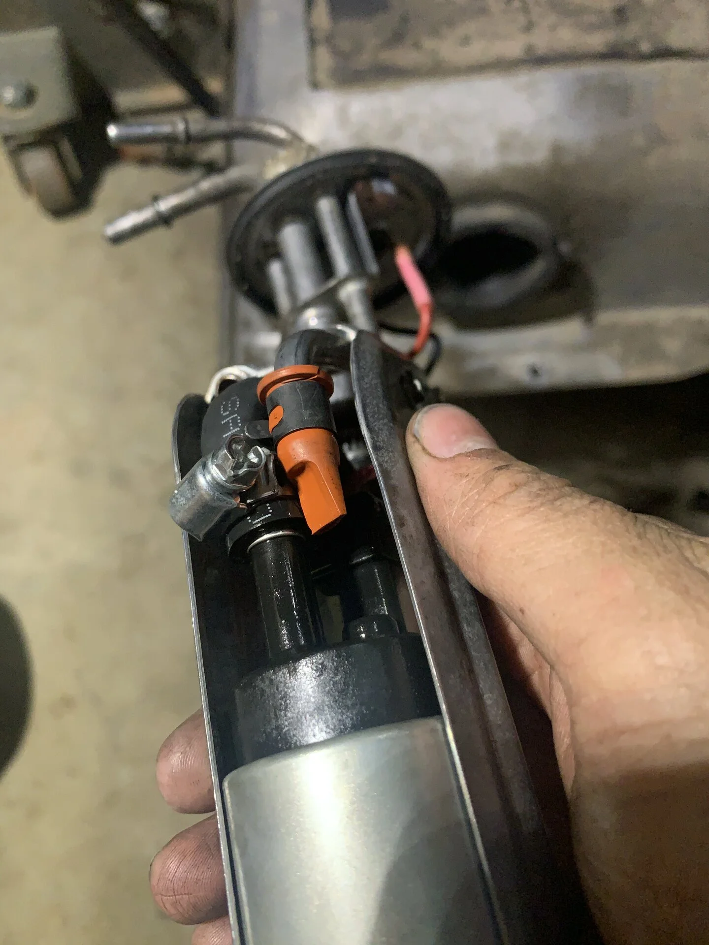

I pulled the pump and found the hose was on the edge of coming off. Put it back tight and it fixed everything!
Ill clear the codes and drive it tomorrow and see if I still get 91 and 41 but so far it feels back to normal.
