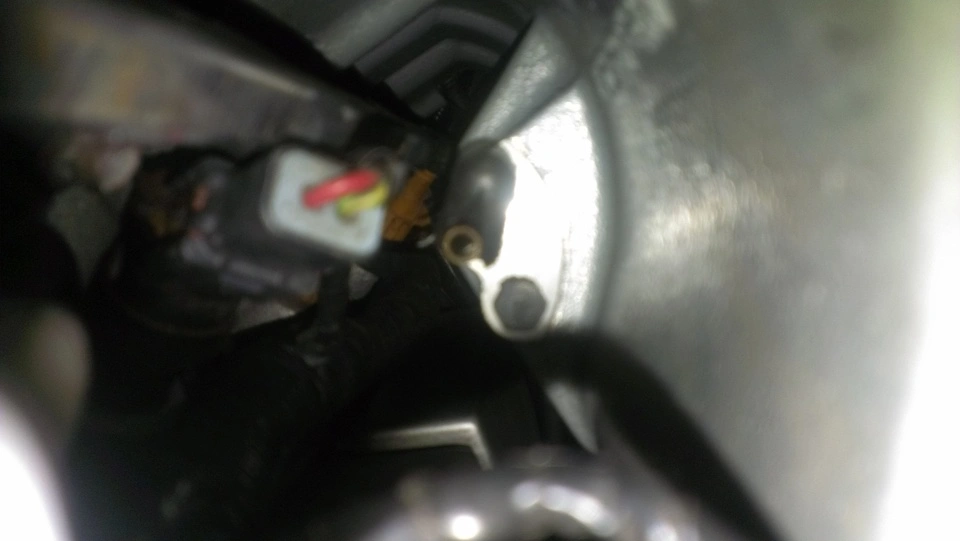

UPDATE: After ruling out anything after the vacc tree, since I bypassed it. I moved onto the intake ports. Sure enough the one looked fine but as soon as I touched it. I found this.
As you can see it was a craked vacc cap on one of the intake ports. I changed the lower intake gaskets a few months ago and replaced all the caps w/ the heavy thick caps and they still crack from the heat. Looks like I'm going to have to find a new way to cap these off b/c the heat is just killing these. I'll clear the codes and road test it later to see if this was the entire cause or just part of it.

Might be heat but also the caps may be too small for the tube. If they are stretched they are more likely to split as yours appears to have done.
