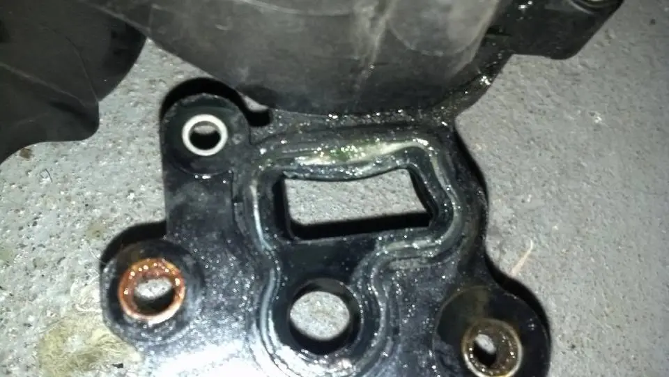

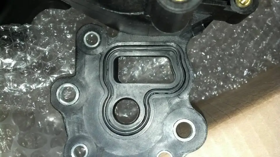

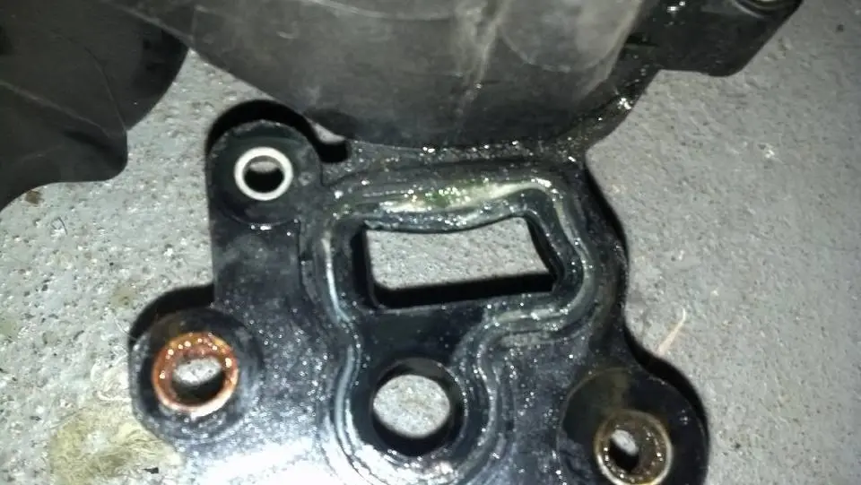

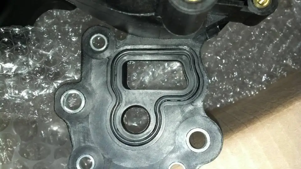

It is a good excuse for a PI swap, but even the aluminum crossover intakes eventually warp and leak. Right under the tstat is where it happens.
That's a metal crossover OEM PI intake that was on my motor and why I never recommend anyone buy a used intake.
Below is how they are supposed to look and how my replacement looked when I got it from LRS.
So even the new ones will eventually have issues but if you get a brand new one like I did it SHOULD last for a very long time.
