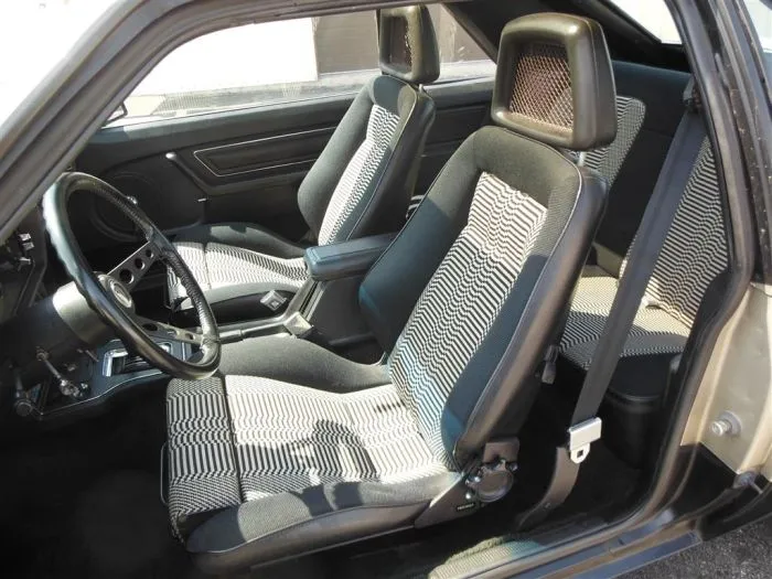

Hey guys! I'm looking to find some racing seats that somewhat resemble the basic shape of the stock seats in a '79 mustang, but with a good bit of bolstering. My stock seats tend to slide me around when taking sharp turns. About as bad as a bench seat...
Any ideas? I'd want to have them reupholstered to match the original pattern and material, so it'd be better if they were bare shells.
Or would it make sense to cut off the top of a simpler bare aluminum Kirkey seat and have that upholstered?
Comfort isn't a massive concern. I'd be fine with just an inch of decent padding.

Take with a grain of salt...
From a safety concern I do not believe their are any lowback racing seat COTS. I have seen some in rat rods and T-buckets but they offer no support/protection if you were ever in a accident, the lack of support would jack up your back and neck.
As for the Kirkey seat in a street application (if this is street)) without the supporting brackets, rollbar/brace and belts...might be worth more of an hassle than it is worth. Has it been done and talked about here before yes, but most would prefer the the alternative below IMO.
Personally I would recommend an SN95 as they are snug fit at 215lbs, 6"0, and good lumbar over the fox and earlier seats.
Are there new versions being made? or would I have to find a pair of old ones?
They seem like they'd be pricey, but I like the idea.
They do sorta make a new version. They are called Recaro Specialist. You won't like what they cost plus the cost of rails and seat bases.
Late 80's VW Recaros are another option. Cheaper, but still pricey. I have these in my car.
You could also go with a set of Corbeau GTS II's, which look similar buy much cheaper.
What color is your interior?
TMI has reupholstery kits for the mustang specific Recaros
