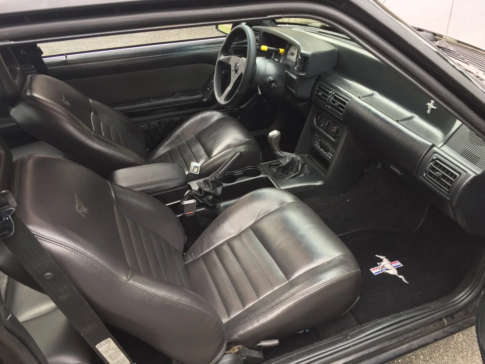

There's an awful lot of factory mustang seats to pick from that are very good for what you say you want out of them. I have an '88 and I have some 2005 seats going in at some point. This allows me to use TMI replacement foam and upholstery if I need to. And you could go up to some seats from the new mustang if you need more support. I'm not opposed to seats from something else unless they are almost impossible to get replacement upholstery for.

No offense to anyone, but I really hate newer seats in foxbody's. They look all kinds of wrong in most cases. Yeah, they may be more comfortable, but they just aren't era correct.

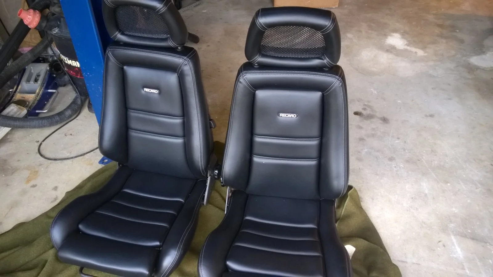

$250 for seats, $400 for sliders and I think $900 to have them redone:
I have since had the rears done to match for $650
My $200 VW Recaros. $400 in sliders and brackets. Gray inserts are original, but I bought new black vinyl trim from someone for $150. I need to work on making the rear seat match next.
Previously, I ran 99-04 seats. They sat high. I hate to say it, but part of me liked them better than the recaros for cruising around. Just more practical and comfortable on long drives. They don't hold you at all.

the VW Recaros seem perfect for my application! The design isn't too overdone, and if I had an upholsterer redo them in the amazing red vinyl already in my car with a similar stitch pattern and perforations, they would look stunning! They look big enough for me too! Where would I get the sliders and brackets?

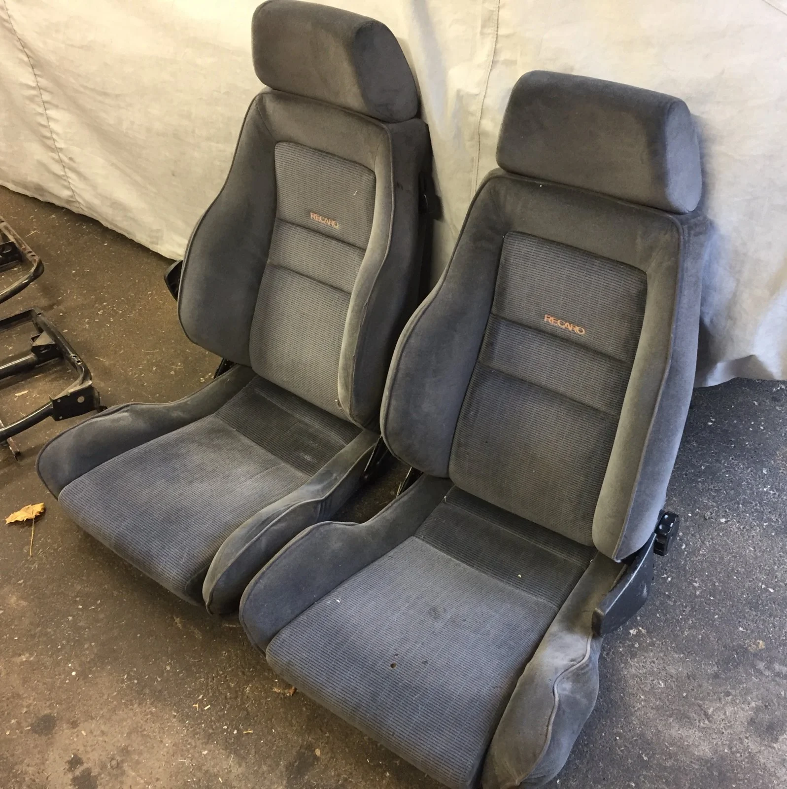

Mine were from an 88-92 VW Jetta GTI/GLI. GTI versions have the flip forward feature to allow backseat access in 2 door cars.
They are the LS-B model of Recaro, which came in a lot of OE cars (mostly in Europe and available in the aftermarket). It has been replaced by the Recaro Specialist today
They looked like these when I bought them for $200 on craigslist.

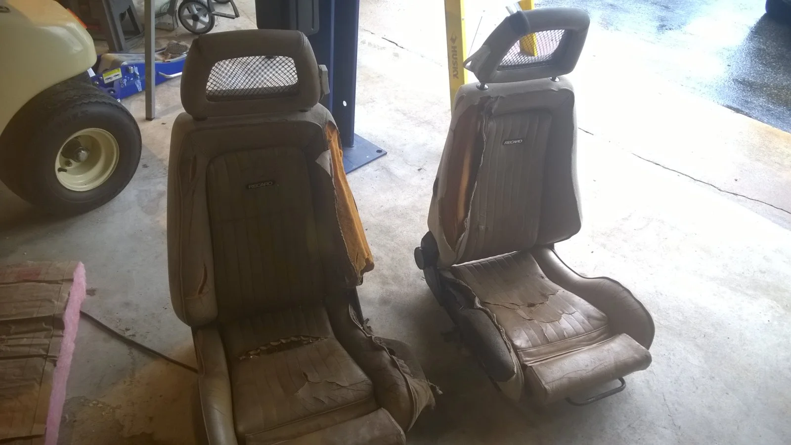

Some of the foam was trashed, and cig burns in the carpet. Restoring them (myself) was a winter project. I sold off some of the old material and plastic and bought new foams and restored several other foams. Details of my work are buried in my project thread from this past winter. Was a fun project.
Seat brackets were from wedge engineering, and the sliders are recaro sliders (p/n 0.70.9NT). These items aren't cheap. $570ish for these alone if you buy new.
