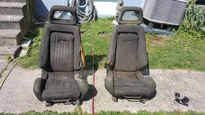

Recaro seat (82 trans am)

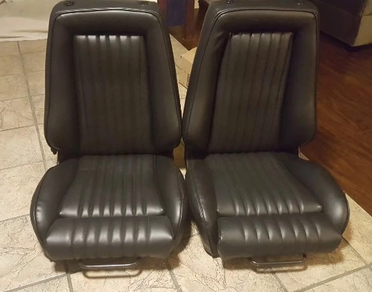

how about factory 85/86 Recaros fairly easy to come by cheap. Or some SVO seats from the same years or i believe they were 84-86 iirc you could also buy the tmi seat foams for both of those and the covers

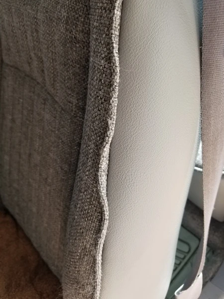

We are on our second set of TMI foam inserts on the Cobra. Over $2500 invested in those seats so far. I've packed them, 2 different upholstery professionals have packed them, foam has been trimmed and trimmed again. The seats are still so far off I don't know what to say. All original except for the TMI foam. I am 5' 7" tall, and my head is rubbing on the head liner. We've actually purchased used New Edge seats to put in the car, and taken them back out to get the factory original seats back in. TMI is currently the only company producing foam for these seats, and I have had a terrible experience trying to make this work over the last 5 years. I can't recommend using factory seats with the expectation that they can be restored.

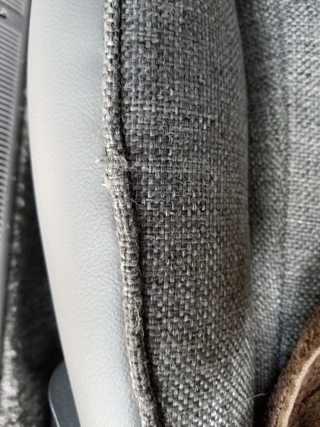

The TMI foam and upholstery I put in my 93 is garbage. I hit my head on the roof where I never did before. And after a month or so of use....yeah, this is quality stuff right here...

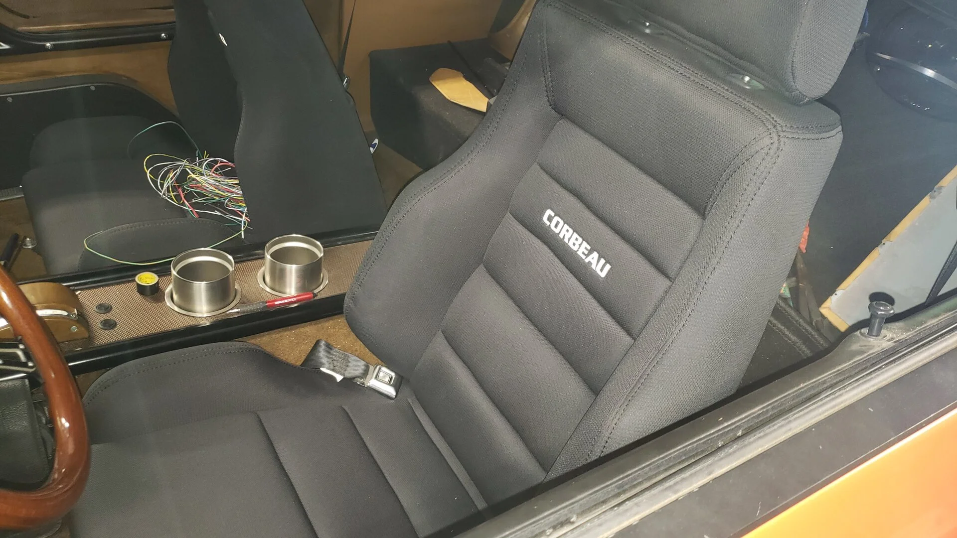

I have Corbeau GTII's and I like them. Seating position is good and they look good initially. After 4 years of use the driver side leg bolster is soft, the seats are a bit faded, and a buddy poked a hole with his keys on the passenger side. That said, everyone who sees them don't even notice their flaws. I have a set of 90s GT seats that I thought about recovering but the TMI stories scare me...

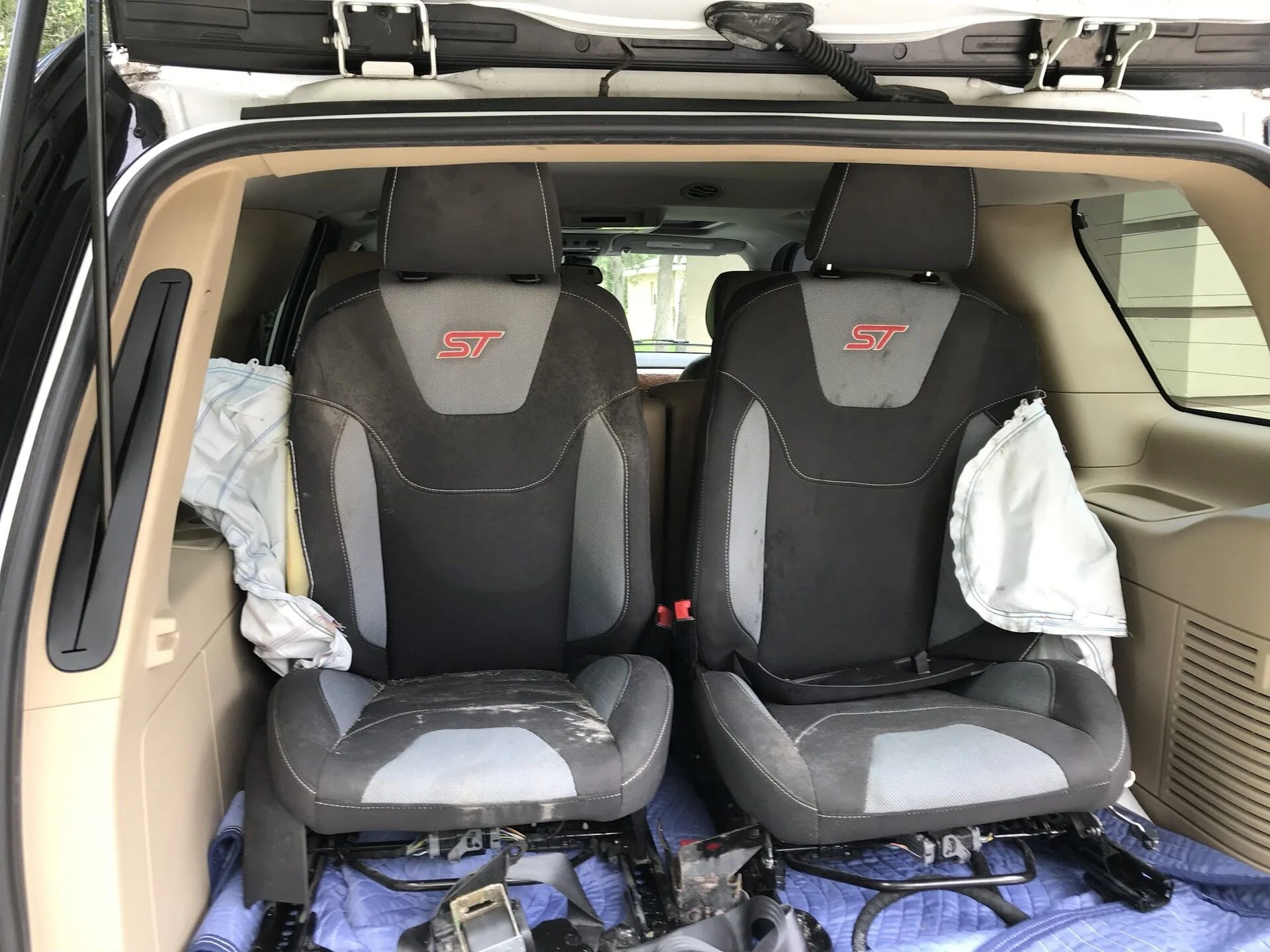

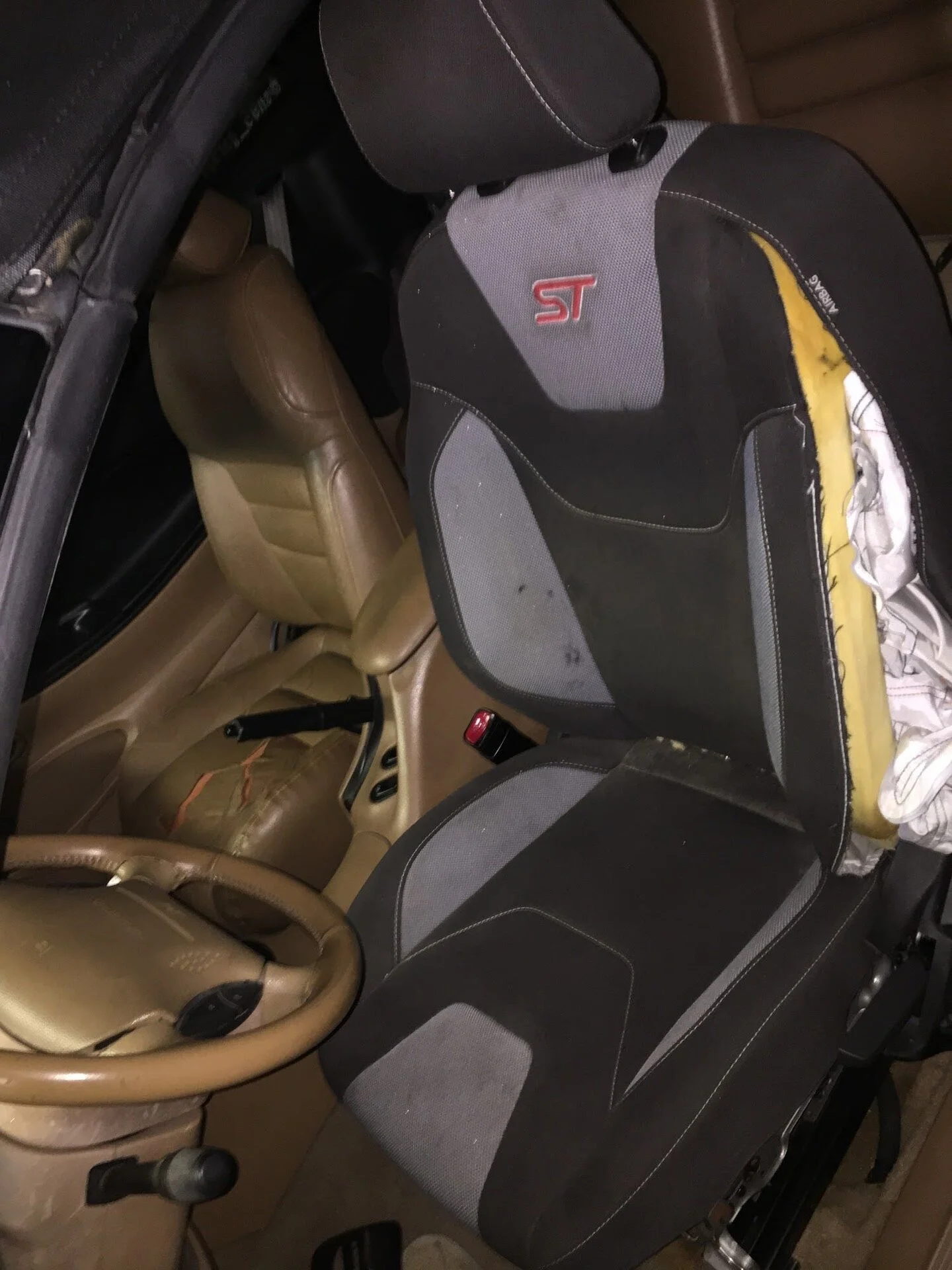

I have some focus st seats that I was going to put in my sn. They'll take some custom bracketry but should work. I am just not comfortable with welding to make them work. They came out of a 19' in the jy with 5k miles. Foam is perfect and its a good candidate to reupholster because the side airbags deployed. They're comfy as anything.
Reactions: Ryuk

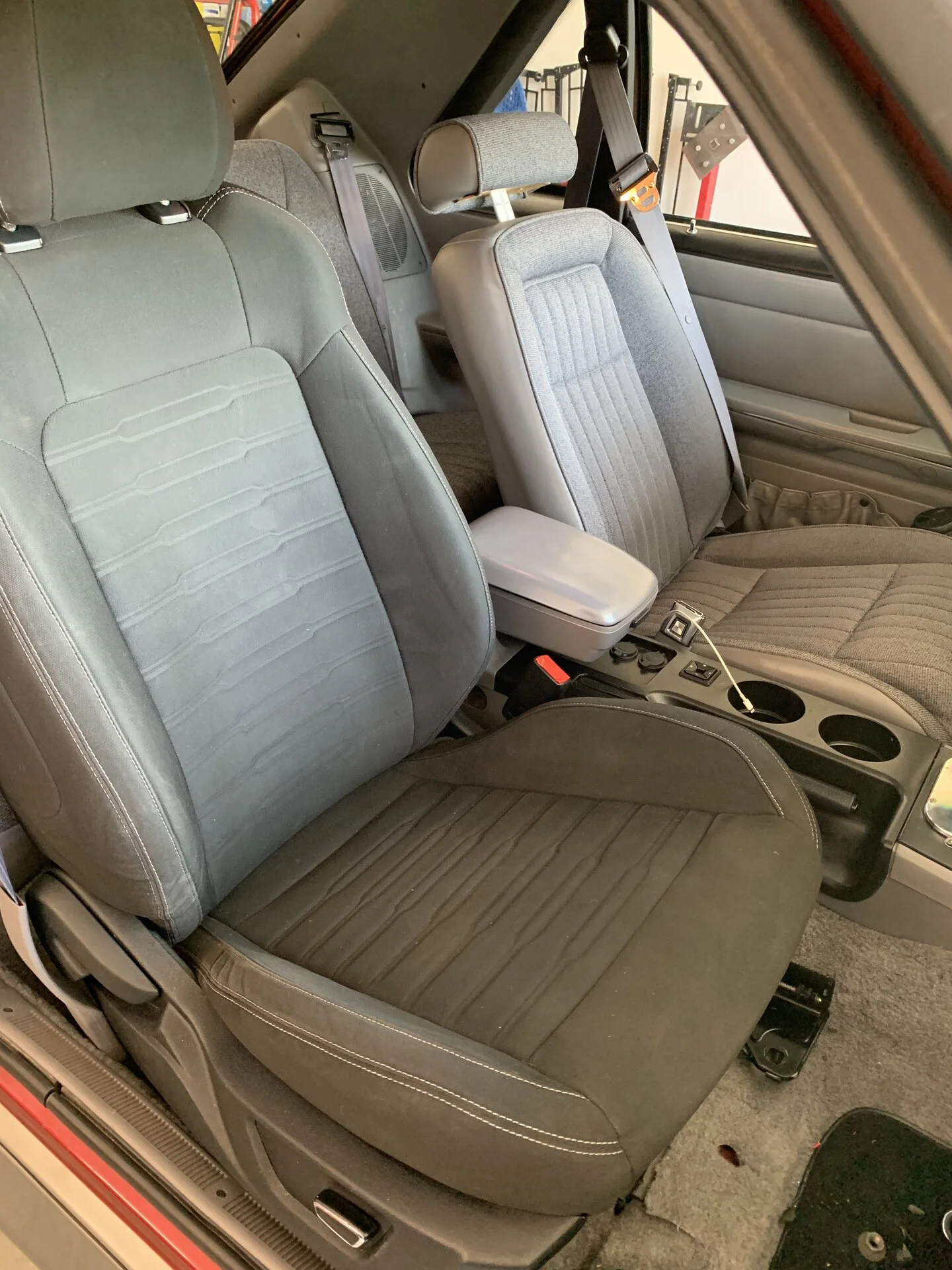

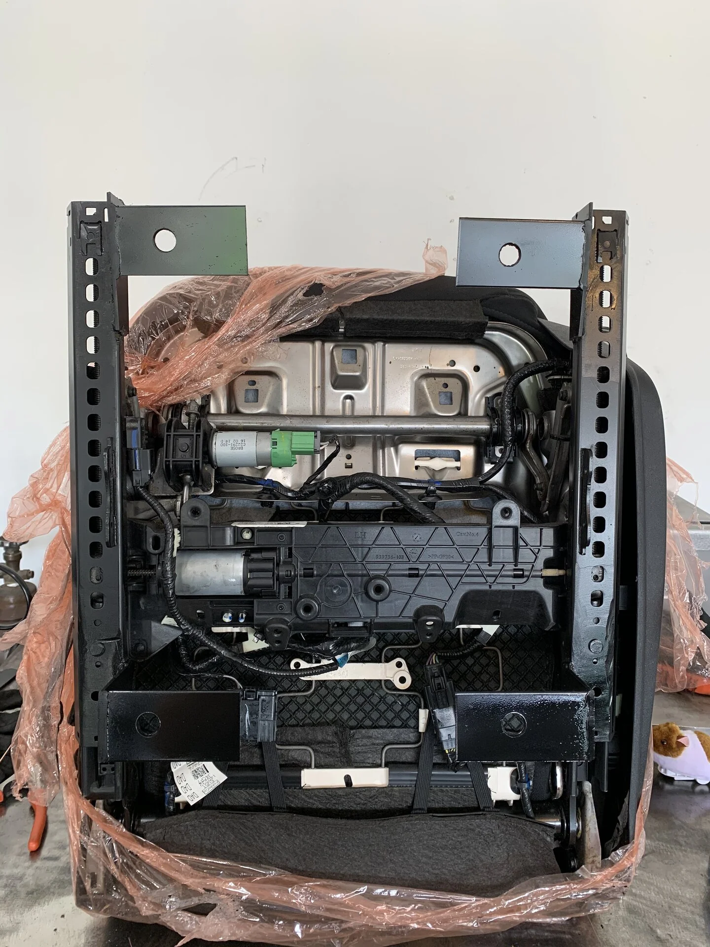

Just finished putting 2015 Mustang Cloth seats in my 93. Not a difficult task if you have basic fabrication skills. Driver is power with lumbar and passenger is only basic power. I am 6’4 and 220 and they fit me great. They do sit slightly higher but probably wouldn’t notice if you were 6’0 or less. They can be had for cheap locally. I picked up mine for $250 for both. Cloth seats are easy to wire with only a power and ground wire for each seat. I was searching for aftermarket seats and were considering Corbeaus but am glad I got these. The bolstering is really nice and would feel great on a track. I took a pic of the frame rails. I removed the stock frame brackets with a cutoff wheel and welded 1/8 inch steel plates to the frame rails using the factory seat brackets as a jig.
-Tim
-Tim
Those newer seats are much easier to reupholster and if you keep your eye out on ebay, you can get stock leather seat covers from Roush as a take off.
Not sure if it's the angle of the pic, but those newer seats look gigantic compared to fox seats.
Maybe i'm just picky, but I still just don't feel visually most newer seats just don't look right right in an 80's car.
