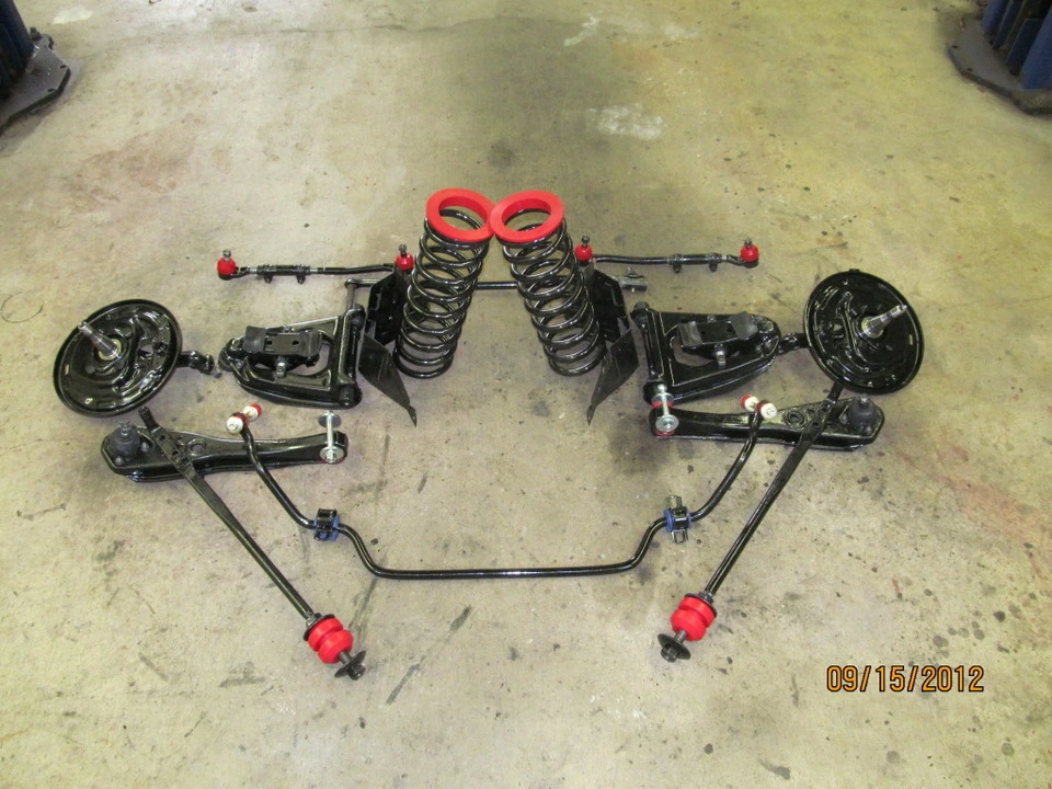

I used my originals but I sandblasted them, welded 1/8 inch steel plat on the bottom of the control arm for extra strength, painted them with por 15, and replaced the bushings with red polyurethane bushings from energy suspension. Of course I replaced the ball joint. If you were to just replace them I would special order the moog control arms from O'Reilly Auto parts.
Heres a pic from when I rebuilt my entire front suspension on my '67, all sandblasted and painted with por 15, and polyurethane bushings on every part.

Where did you get all the bushings from. That looks really good.
