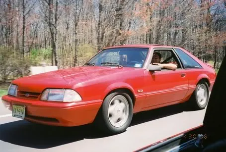

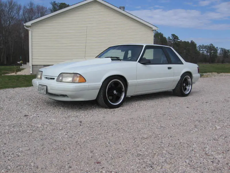

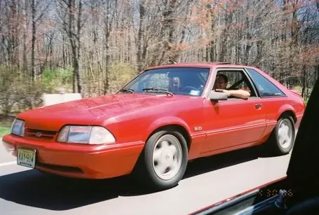

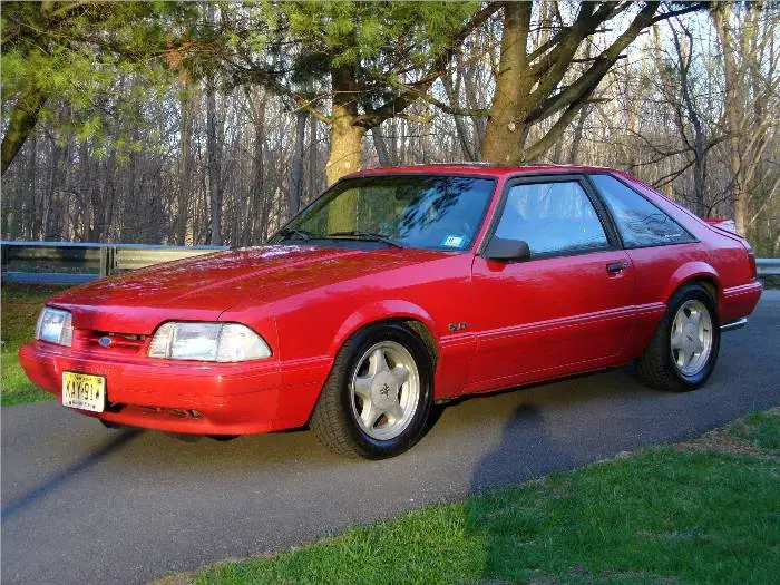

My spring package is Photoshop!

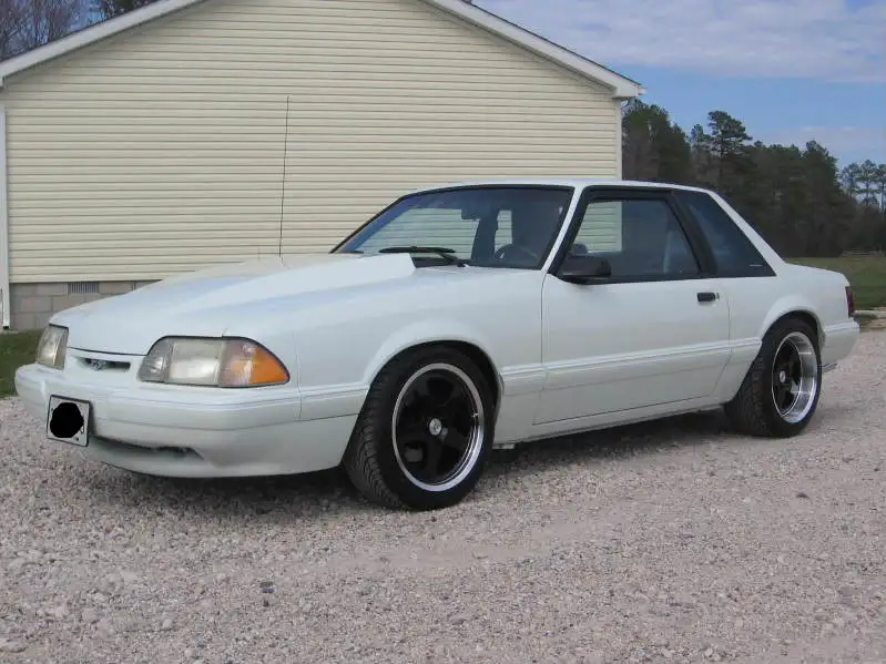

Eibach sportlines front and rear, removed bottom isolaters in front, strange adjustable shocks and struts, steeda x2 ball joints.
What rear axles are you running and what did you have to do fitment wise in the rear to get those on there? Do you have any rubbing issues in the front?

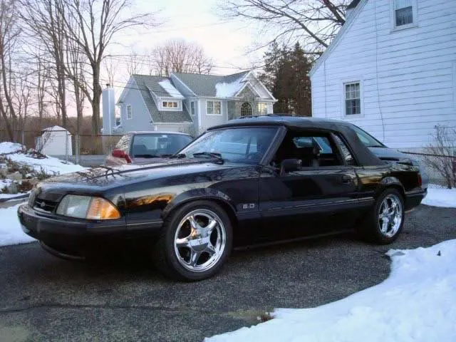

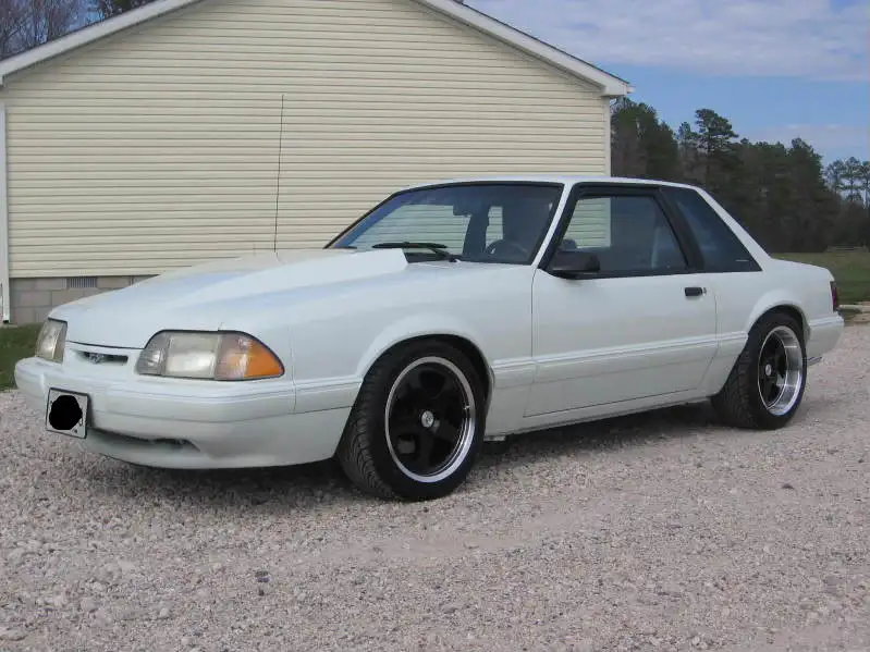

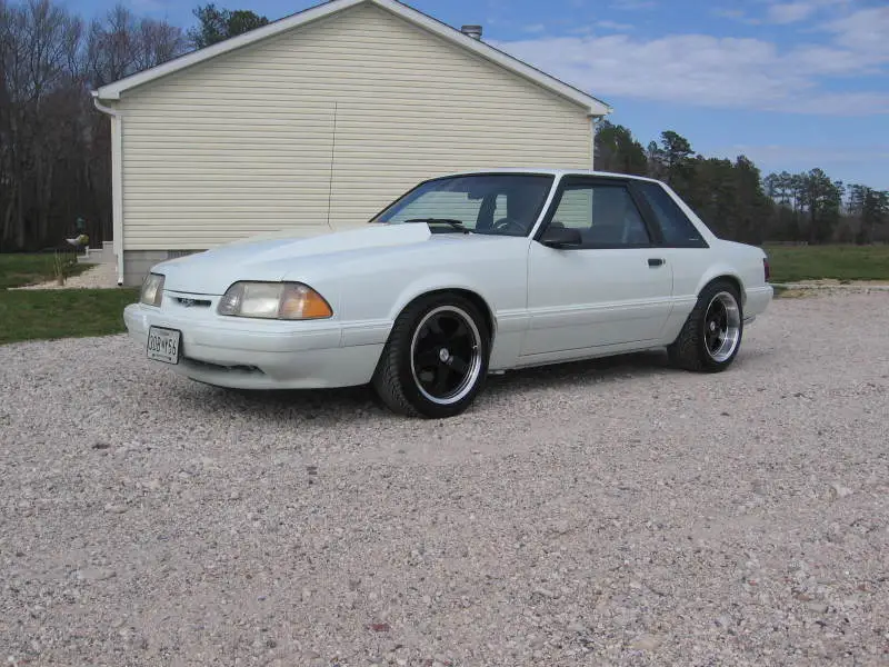

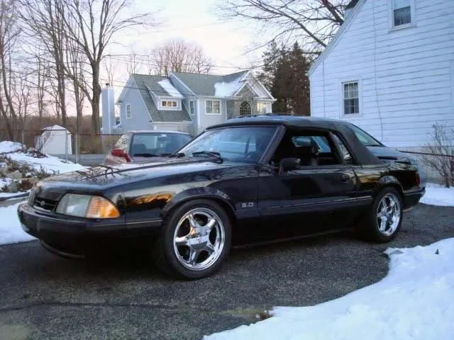

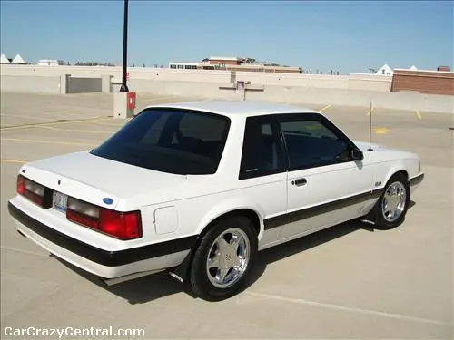

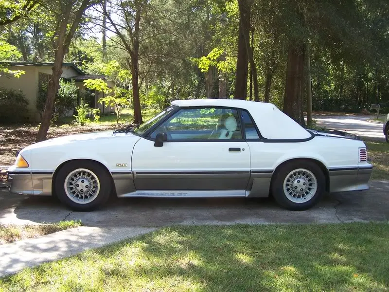

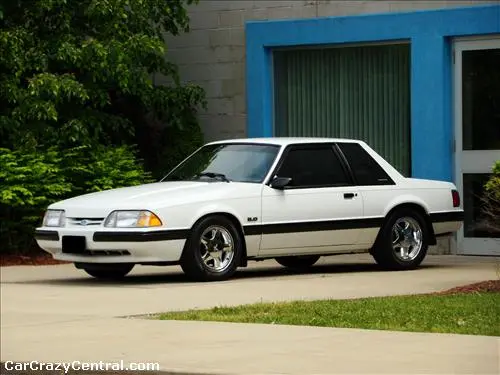

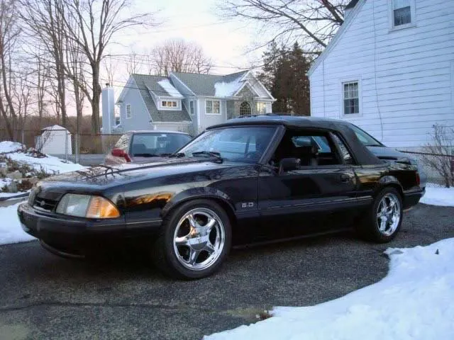

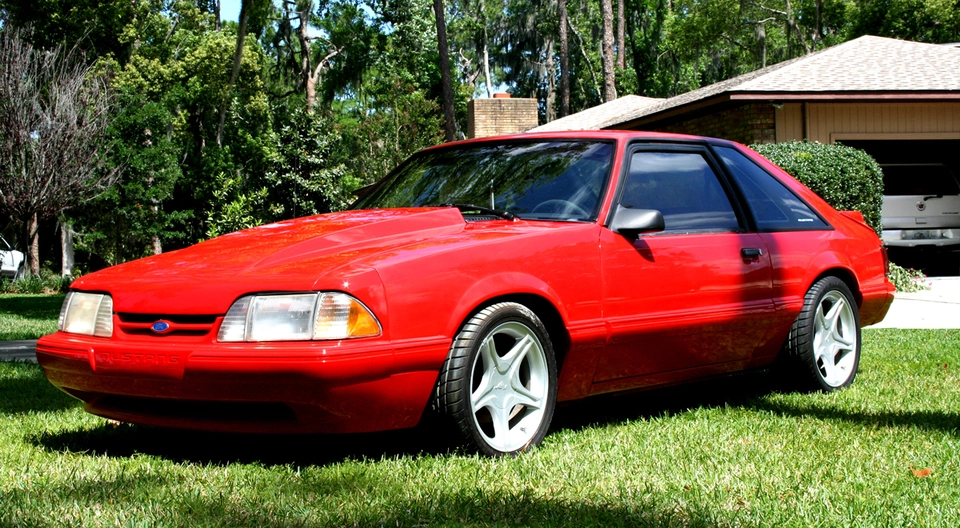

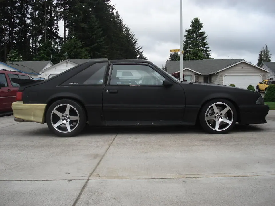

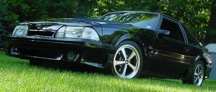

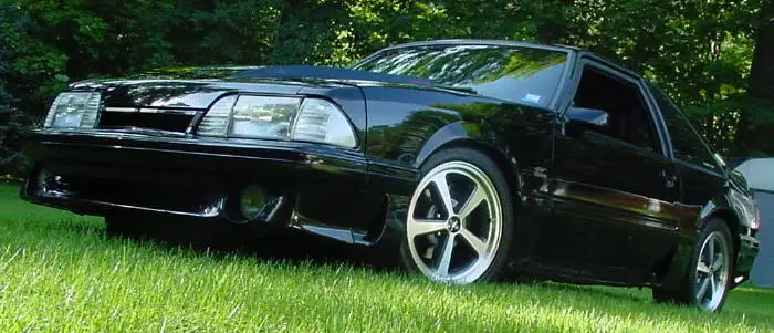

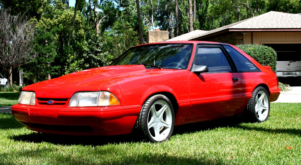

Heres mine with b springs and stock struts and shocks. Mine ride's the same as it did before i lowered it.
I banged in the inner fenders with a BFH , rolled the fenders, used stock length axles, 3/8 in wheel spacers, MM panhard bar. I can go with 1/4 inch spacers which im going to soon, the current spacers sit the wheels right AT the fender. The front is actually lower now than in the pic, after I got the k-member installed it lowered more and pushed the wheels forward a little bit so I am going to switch to tubular a-ams soon to get coilovers installed.

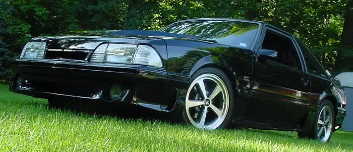

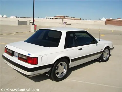

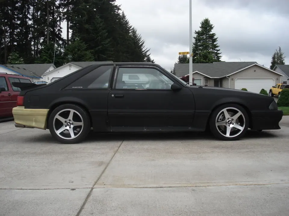

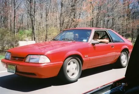

Here is my current car, plus a couple others that I had in the past...
Dugan Racing Tr1ck One Setup...Springs/Shocks/Struts...the works...rides a little harsh but nothing horrible
B Springs with KYBs's...rode very well...I think the FRPP springs give the best ride
Cut Eibach's with Stock shocks/struts...Rode like crap

Thanks, the blue one is my current stang, the other two are from a few years back are are just 2 from the fleet that I've had. I have owned 14 total Mustangs from a 79 2.3 Turbo hatch to a 2003 GT on deep dish Bullitts. I'm sick, haha.
