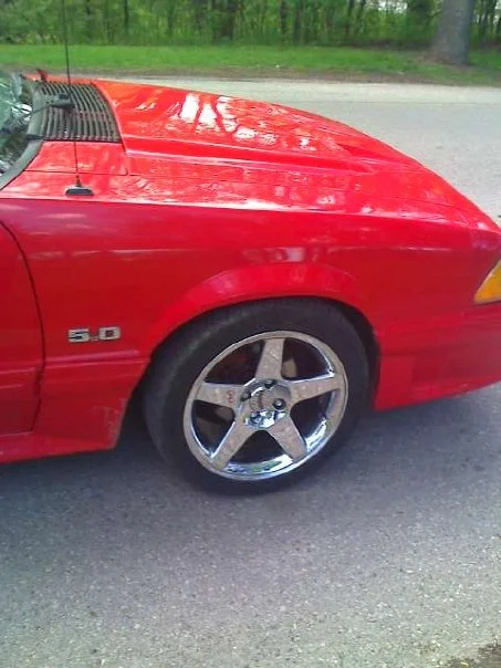

Lowered foxbody pics

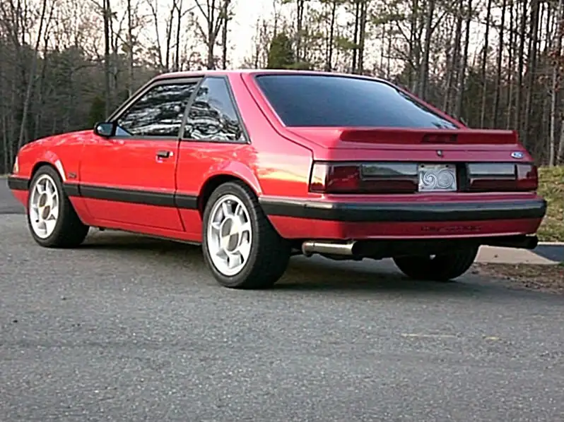

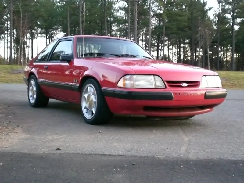

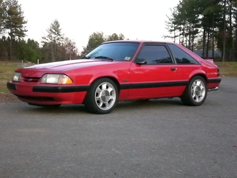

sorry abt the quality there just quik pics from last summer with my cellphone

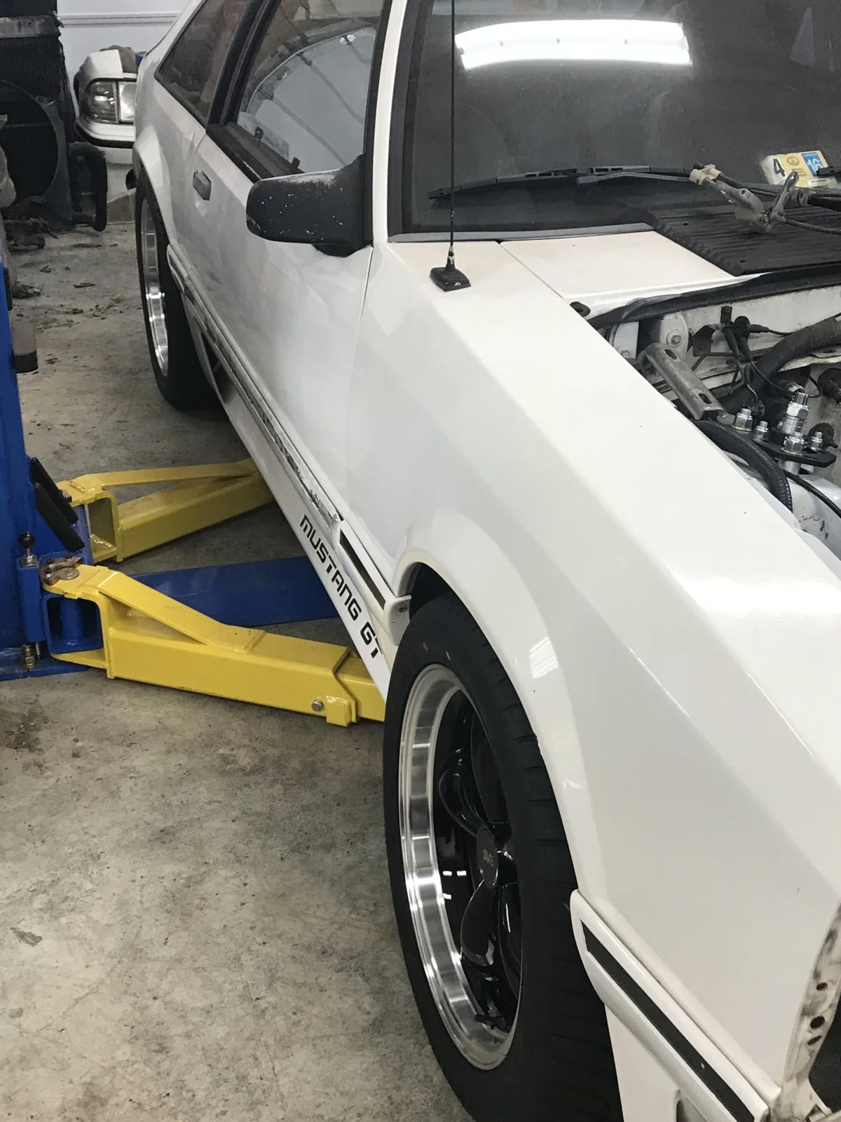

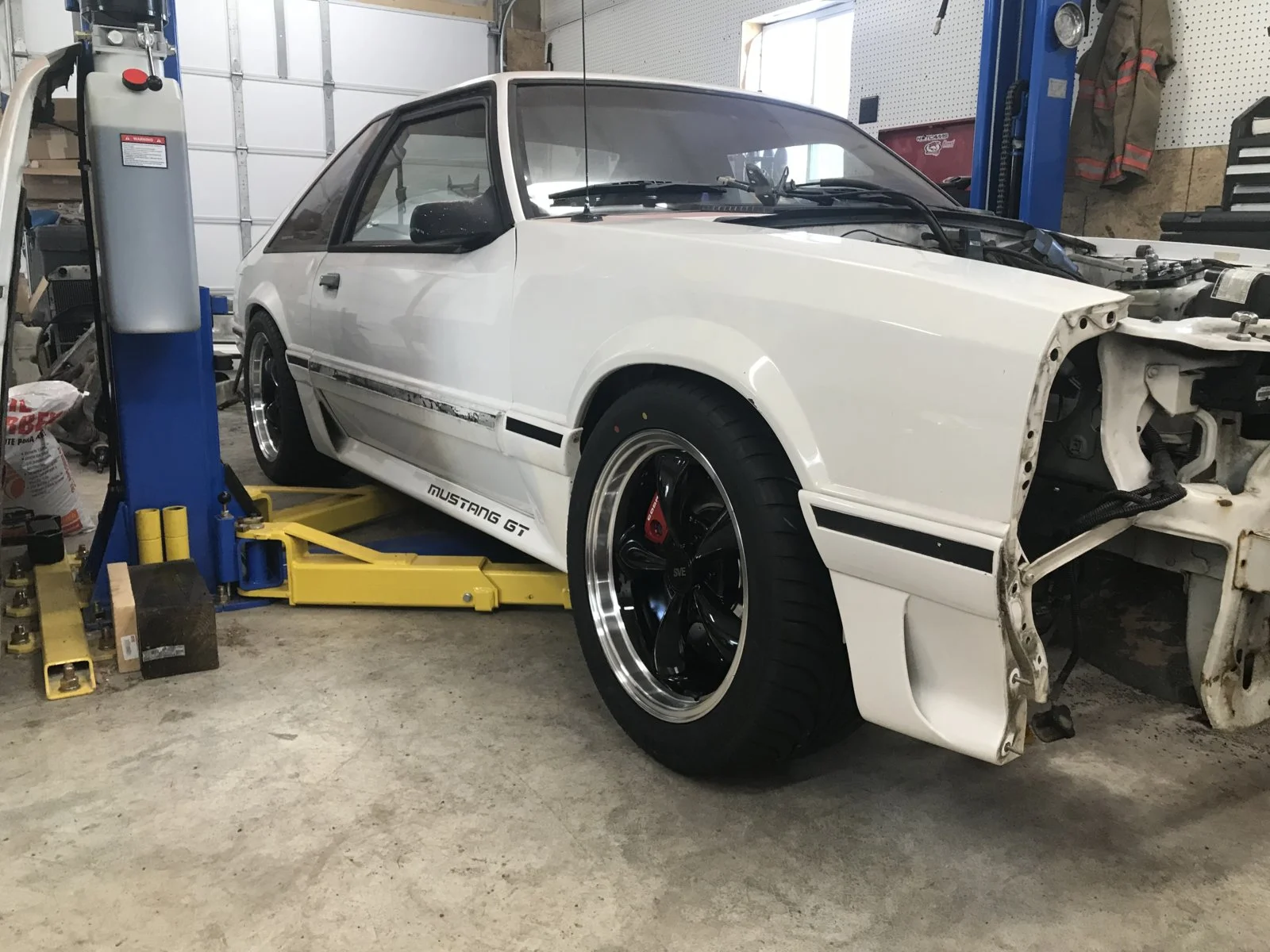

I hope I can leave it at this height when it’s finally back together. I still need to roll the fenders but I think I may have rub at this height in real world driving. We’ll see. I’m sitting on MM coilovers front and rear, MM K member, control arms, PH bar and their in-house Sport valved dampers. I purchased everything on their recommendations. Looking forward to the test drive, but it may be a while. Lol

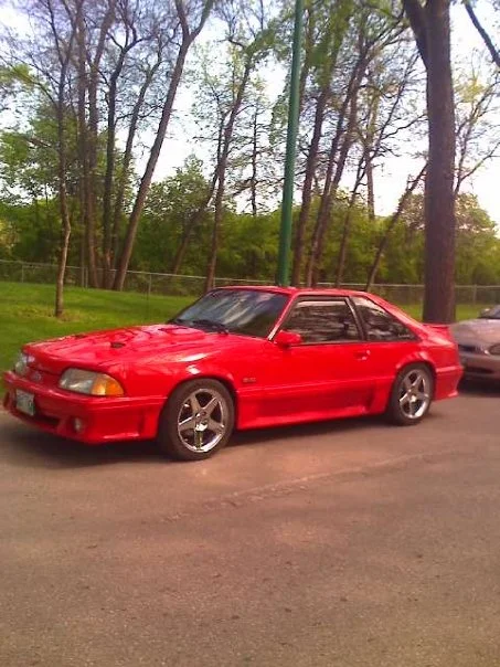

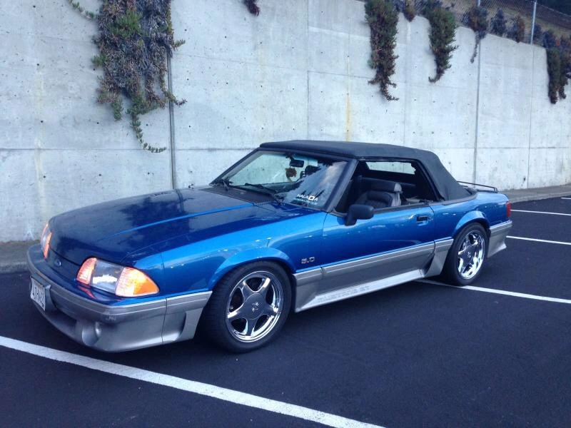

sve lowering springs (for coupe/hatchbacks) and kyb struts and shocks with bbk cc plates and bbk gripp upper and lower rear control arms.
by not getting the sve lowering springs specifically for verts, it was a lower drop with the coupe hatch springs. worked out well.
edit: this was my previous fox
