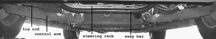

Well the cc plates will be a 50/50 shot, check the alignment afterwards and see whats needed. Bumpsteer is another issue, if you dont notice hardly any now you probably wont afterwards. I had cc plates on mine but not anything for bumpsteer.
My bumpsteer is getting excessive, especially while braking on a bumpy road! Where can I find a bumpsteer kit? And Tom, I was there during the rack n pinion offset bushing installation and all those did was raise the rack n pinion a bit so it wont be in a ''squated'' position when lowered.
so how's that going to correct how the springs and control arms are affect by changing the roll center, doesn't do squat
Edit: pic taken from the miracerros site
