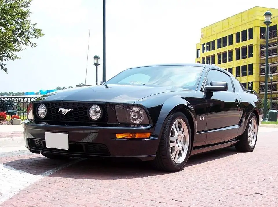

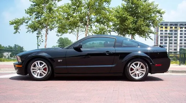

I used the Sportlines and afterwards had the alignment checked. No toe in / out, alignment oir camber adjustments needed. The rear end was aligned when they replaced it after the lowering. So, with now, no panhard bar needed. But I will be replacing it regardless.
Here are some pics.
