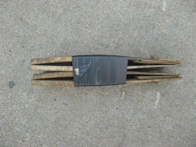

I was inspired by this thread to do this mod on my kids' '65, when two sets of "one inch lowering" springs -- one set a 4-leaf "mid-eye" from Mustangs Plus, the other a 4-leaf 153# Eaton set from NPD -- gave it the 4x4 look.
I looked high and low for those U-bolt clamps like Opentracker has, and finally I gave up and made my own out of some bar stock:
Just a suggestion for those who have the same prob I did to find the U-bolt clamps. I heard after the fact that a spring shop will bend up the bolts for you, but if you've got the materials sitting around and you don't like to depend on a vendor for a one-off part -- in my experience a toss-up with a visit to the dentist -- you can make your own.

hmm, good question. I built my car to handle, but I was also prepping it for driving it across the country last summer. If you look at the photos in this thread, my orange car and my yellow car are one in the same. With that said, the lowering of the orange car is with a new set of 5 leaf springs with a #2 and #3 installed, so actually it was 7 leafs in my case. That was how I drove it across the country, with about 300 extra pounds in the car, trunk, rear seat and my 110 lb passenger inluded. Every bump, dip, nook and cranny was felt though the rear end to the bump stops and the exhaust. When I hit my destination I emptied the car, by myself if I hit a small dip the tail pipes would still get sandwiched, BANG!. The pics of the yellow car as shown in this thread are of the set up described minus the smaller of the two added leafs. It raised the car about 1/2 inch and have not had a sngl bumpy incident, even with a passenger. Each setup will be different. The only real formula to this is try it, if its too low, remove a leaf from the top side(negative arch). If its too high, add another leaf to the top side(neg arch). Trial and error. Free mod, safer than 3" blocks.

They are held together with the bolt that goes through the middle of the springs. Take that bolt out and the springs come apart. Put back the springs you want, in the order you want and put the bolt back it. That's about it.

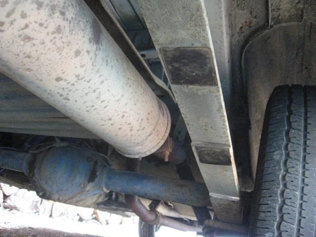

I've been trying something new with the leaf spring rear. Just for fun, I cut some off the back of each leaf on my new $100 car.
It's a 68 Ranchero and it sat way too high in the rear. I'm to busy to take it apart so I thought, why not cut some like we do on the front. It worked.
These photos are of our 65 Ranchero I just got done doing it too. It lowered the rear about 3/4" with no loss in ride quality or added noise.
I used a pry bar to separate the leafs and used a cut off wheel. Super easy and free. I'm sure it takes away some of the spring rate but that's OK with me.
I only cut the rear, I dont think cutting the front is a good idea.
I'll be doing this some more for sure. It saves a lot of time.
THis is how much I cut off. I cut a lot more off of my 68 Ranchero.
I think you just gave me something to do this weekend. I've had reverse-eye springs for years and they never settled, and they're stiff to the point that the rear axle hops on bumpy corners. I've just been too lazy and cheap to get a pair of 1" blocks to even out my ride height. Shouldn't the rubber sliders go back in, though?
