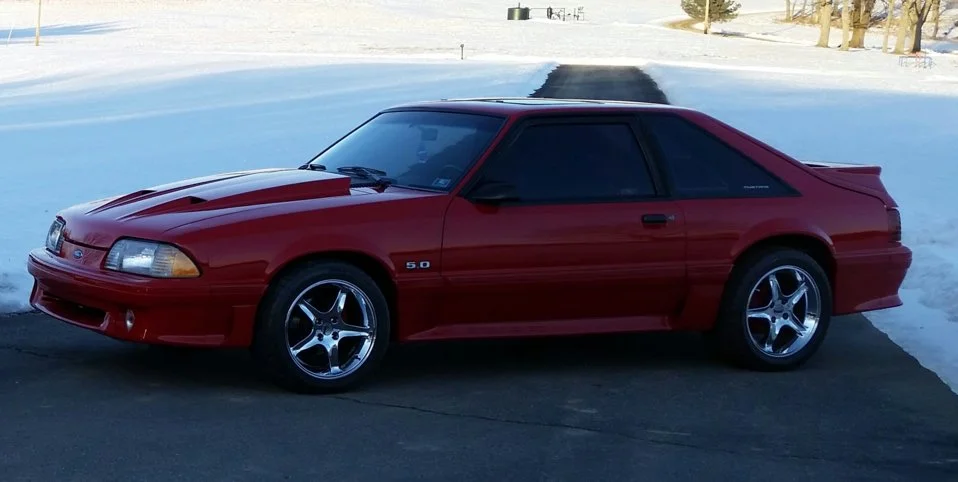

Ok guys I am a newer member to stang net and this is my first thread. I have a 1990 gt. The car has 55xxx miles and is pretty stock. I have 17x9 cobra rs running 245 45 r 17 and 275 40 r 17 out back. Currently all stock suspension except for front struts which are kyb. Still has quad shocks and are not flipped. I have no rubbing. I would like to get rid of my monster truck stance but not slam my car.
I want to know how to lower my car just enough and if there is a way to do it that will actually make it ride good, handle good and hook good. I do not want to sacrifice anything except for obviously a little ground clearance. I do not want to start eating up tires or rubbing fenders. If additional parts are needed to do this I will buy them like c/c plates. Also I don't think I want to cut springs or remove isolators I believe this would have negative effects.
  • So what springs do I need.
  • maybe I want coil overs?
  • can I run my current wheel and tire setup.
  • do I need additional parts.
Maybe I over think things but I don't want to take a car that has no issues and cause them. My car is a Sunday driver with the family that takes an occasional trip down the strip. I also enjoy my high speed exit from time to time when the family is not with me.

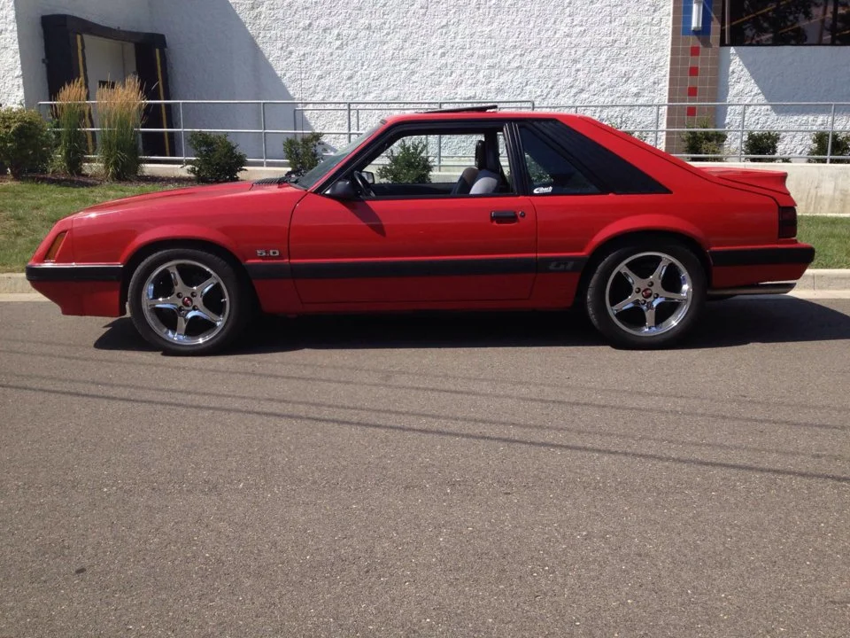

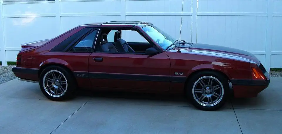

I started out on the roundy round with lowering springs,the ride suffered and the advertised drop was never what I expected,needless to say I got off that marry-go-round very quickly.Ya the initial investment is smaller purchasing lowering springs(or multiple sets to get the drop you desire),but I could have saved a lot of money in that year not removing new parts that I had just installed.
My '86 in my DD 7-8 months a year,for me the reason for the suspension changes was ALL about making the ride MORE compliant,much better handling was just a bonus************The ride may be stiffer than stock but now the suspension just eats up the bumps instead of crashing over them.************This is accomplished by removing all the bind(which adds WR) in the front/rear suspension which in turn increases the ride quality.
NOTE:Decreasing chassis flex will allow the suspension to work as intended and actually help increase the ride quality,enough can't be said about installing FLSC.
Good luck
Reactions: Mustang5L5
Guys thanks for the feed back. Old man river your car has the exact stance I am looking for.

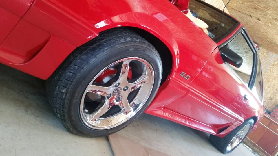

In the pic my wheel tire size is 17x10 with 285/40 and 17x9 with 245/45.Currently I had to make the switch to a square setup with 17x9 out back due to the lower roll center produced by the Torque Arm.I had way too much rubbing on the inside wheel house when going up inclines,enough to almost stop the car when entering my driveway ect.A lot of this could be avoided by increasing the rear spring rate(already have MM T/A street springs installed 375#-440#)but I would be opening up a whole other can of worms,would need to increase the front spring rate to match which would make for a much more stiffer ride than I'm willing to put up with on a street car.In MY situation swapping to a narrower wheel was my only option to maintain good ride characteristics.
