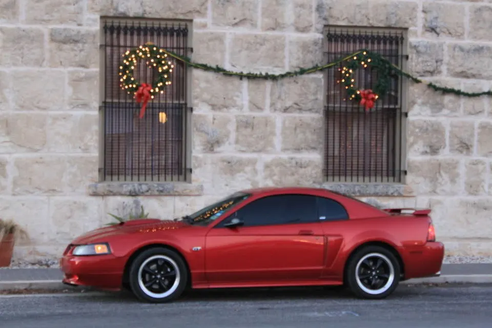

I've got the Eibach Pro Kit 3510.140 with stock suspension. Ride quality is more firm than stock, and it's still comfortable. Their website says 1.1 " drop front/back, but mine have settled in around 1.6" front/1.5 rear". Barring any unexpected issues my next purchase will be MM cast/camb plates.
Taken last spring a couple of months after installing the springs
