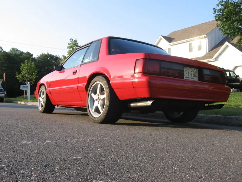

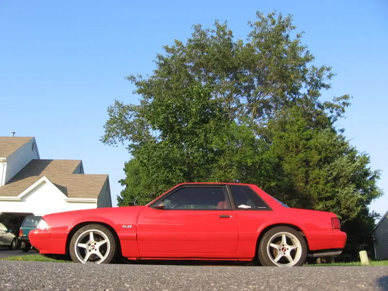

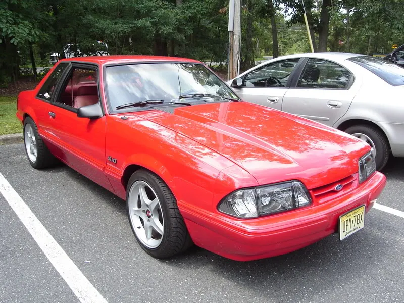

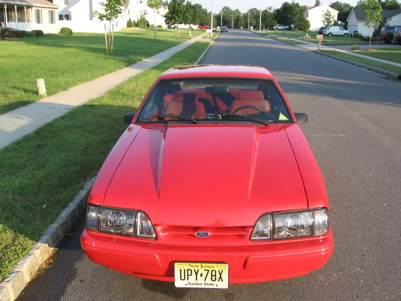

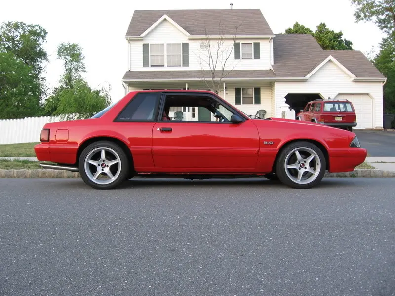

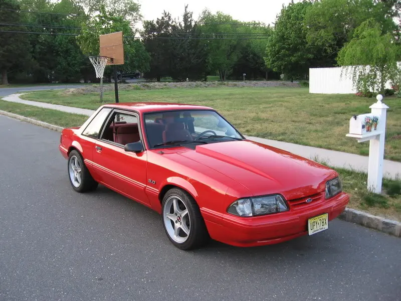

Prepped the car myself.. the rest is 100% maaco 500 dollar paint job.. one stage, no wetstanding or anything..
never had a huge problem with macco.. Always did my own body work and prepping.. brought them a stripped car to paint (even taped some of the stuff i know they would eff up on)..
That looks pretty damn good.... How long ago did you have it painted?
No offense but the red stang with the single stage probably doesnt look so great paint wise in person. Single stage will fade a lot faster and if you attempt to rub it or buff it youll pull paint off since theres no seperate clear coat. One good thing about a good cheap single stage over a cheap base coat/ clear coat is with the single stage theres less material to sand off lol and makes good guide coat for blocking the wavy doors and shoddy body work.

Yours looks damn good:nice:
