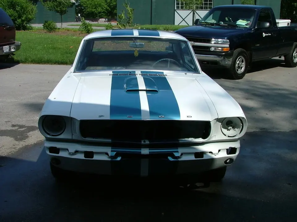

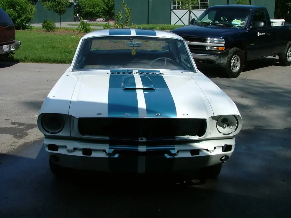

Here's a shot of my car right after I finished the stripes. As you can see, it ain't exactly Boyd Coddington's paint booth, but by keeping the floor clean and wet, and remasking the car everytime I sand anything, it has very little debris anywhere.
Jim

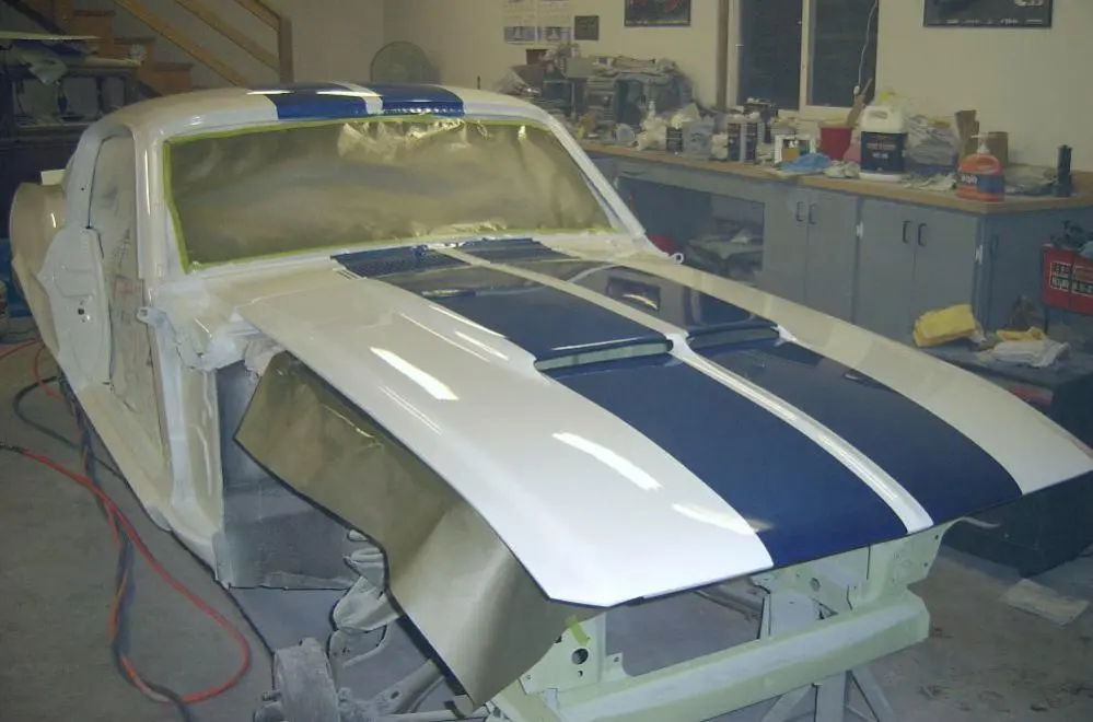

i've painted in vocational many times and one problem i have is tring to make the base coat shine. It should not shine, it should look very dull. as far as sanding between the primer and base, i use 500 grit. once you go over it, if you have any high or low spots, the dust from the sanding will make them more visable. for sanding between clears, im not 100% sure on this. somewhere in the 1000 to 2000 grit range.
