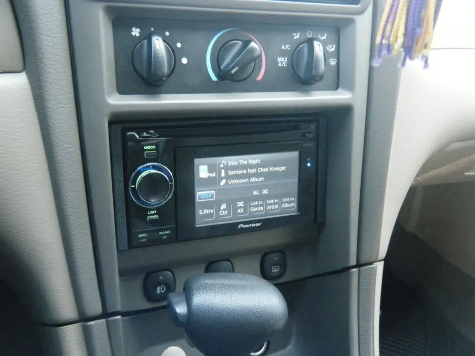

I overhauled my system last week, I put a Set of JBL components in the front, and jbl co-axes in the back. Those are run by a JBL 4 channel amp, and I've also got an alping 10" sub, powered by a kicker amp, and it's all run by a Pioneer U310 bt
