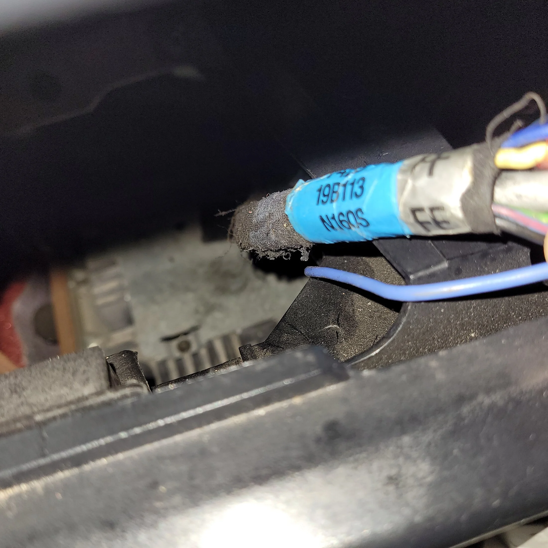

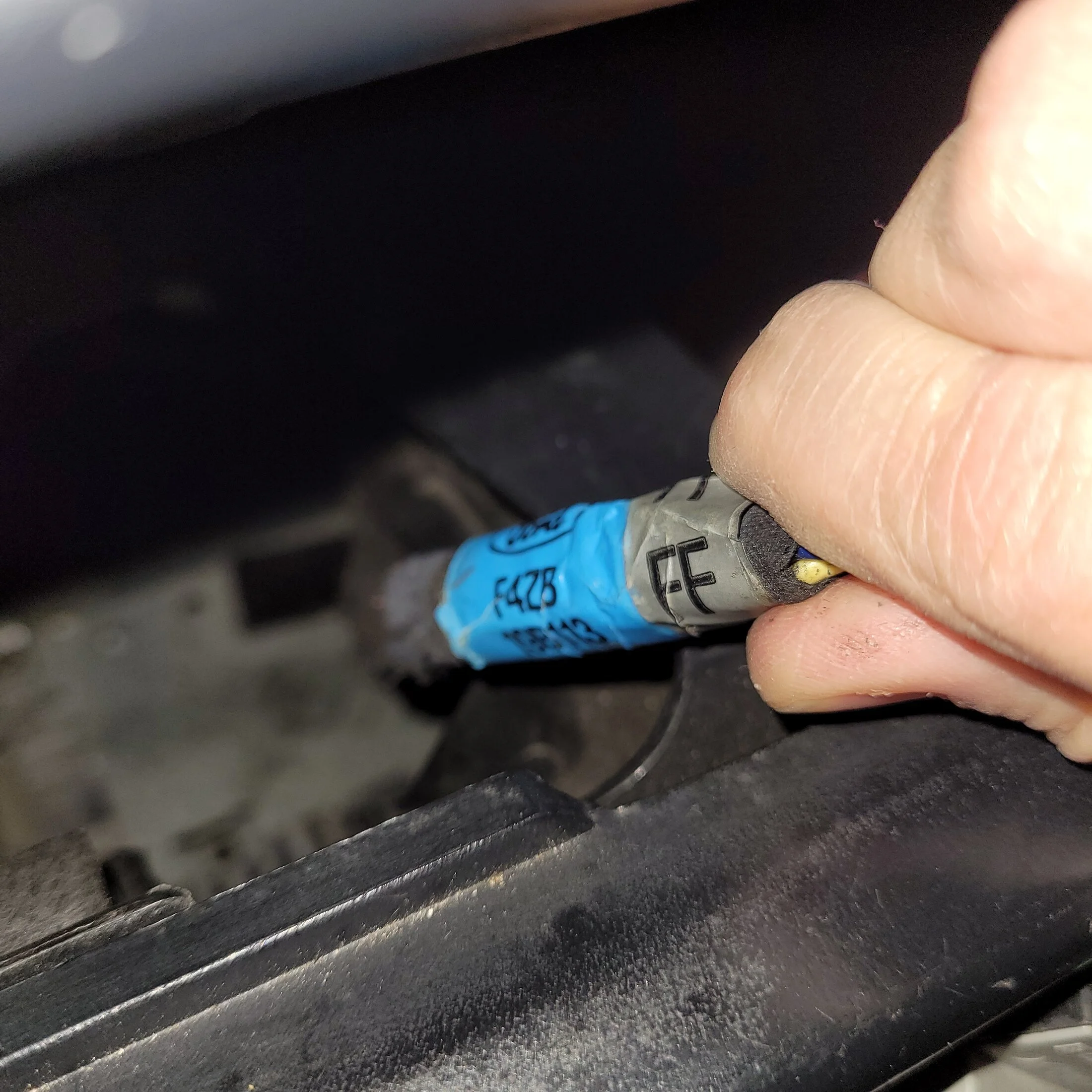

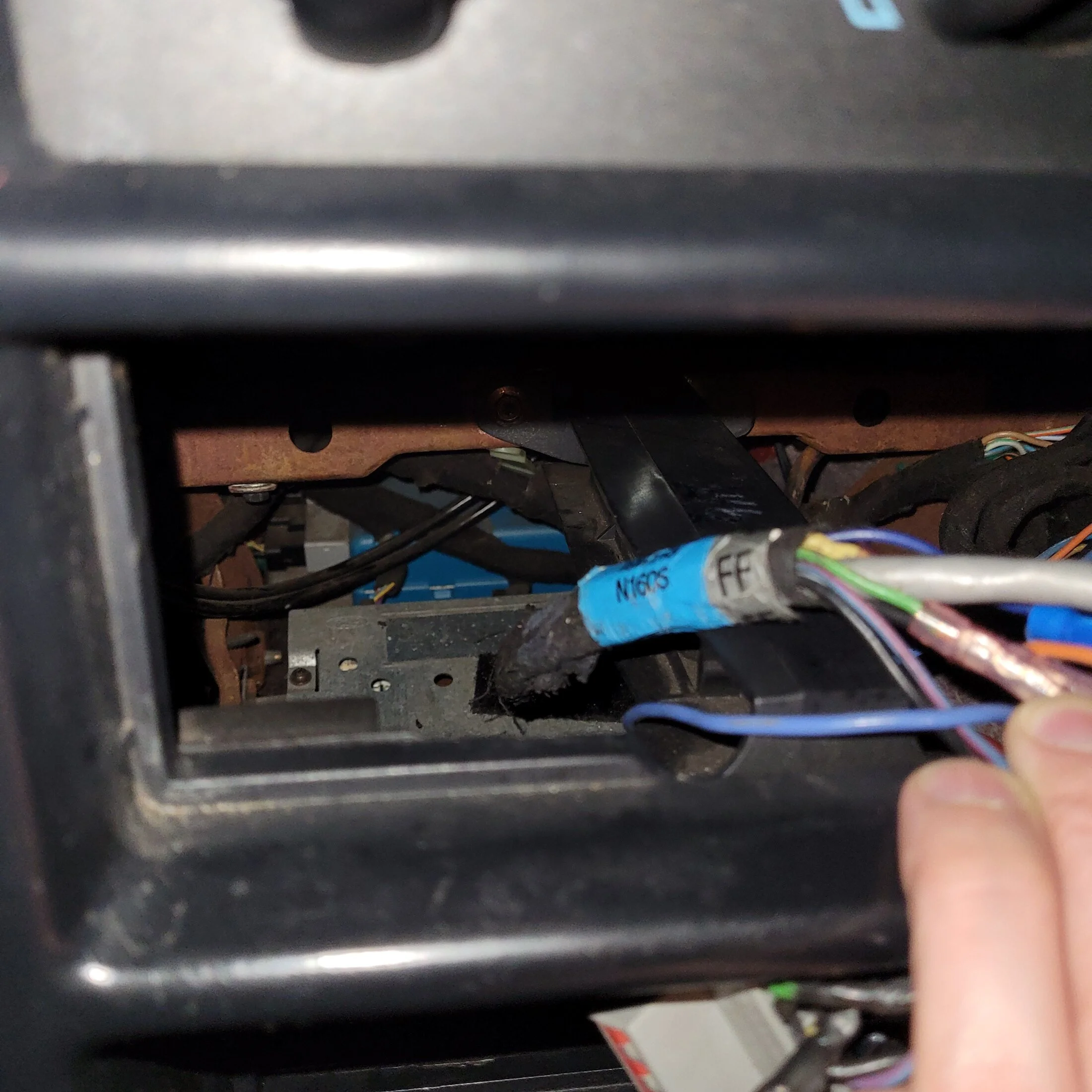

my question is are the mach460 wire harness all the same regardless of the parts numbers? Mine has been chopped up and i just purchased one from eBay that came out of the same year of my stang but the part number is different,
