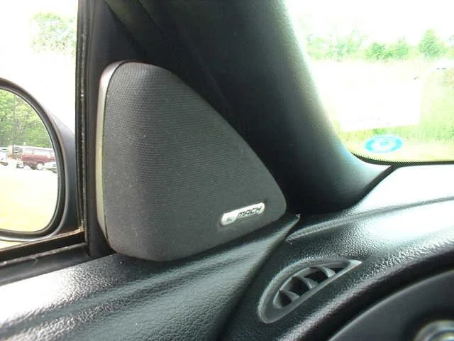

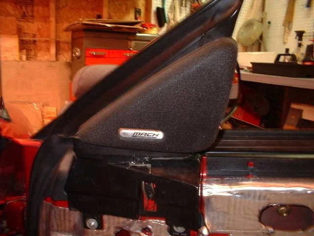

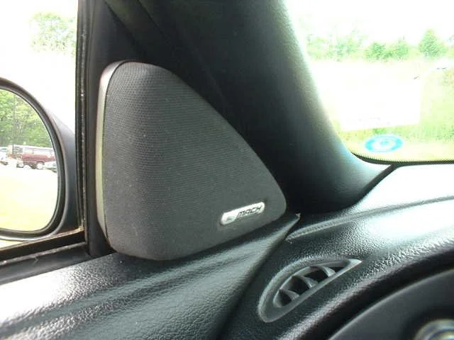

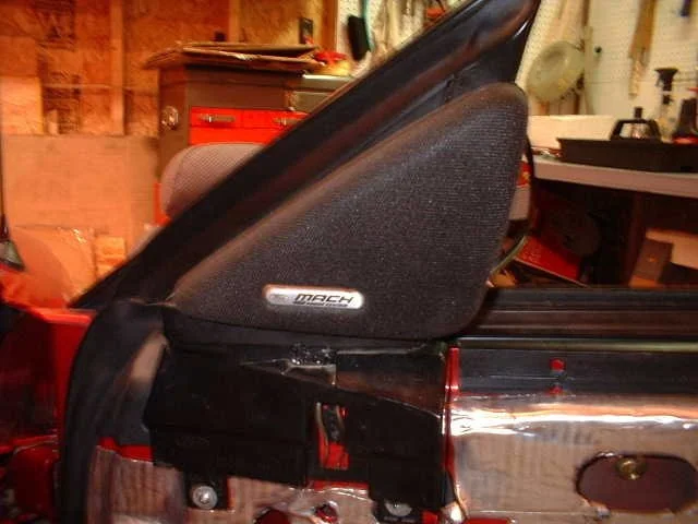

I put the Mach 460 tweeters in my 94, and it wasnt that hard.
I bought the whole shebang, housing, tweeters, and plastic mounts. My door panel already had the holes drilled for the mounts, and all I had to do was wire up the tweeters and trim some plastic off the door so it the cover didnt hit the dash. I doubt you could just mount the covers on the stock part, becayse they mount completely different.

I also threw them in, took some customiseation to get them in. My doors wernt set up for them, I had to chop off part of the plastic housing of the tweeter pod to get them to fit right. I have my focal tweeters behind them, wanted my stereo to look stock. Mabye the proper way is to attach with clips or special bracket but the guy I bought them off of might not of given me them if thats the case.
