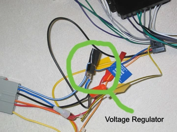

I recently installed a Pioneer DEH-P7700MP in my 2000 GT with Mach 460. The Pioneer head unit is a 12 volt system while the stock head unit is a 5 volt system. The voltage mismatch is causing the popping sound. You need to wire in a voltage regulator. Radio Shack part number 276-1770 will do the trick. It is a small square with three prongs (input, ground, output). The blue/white wire from the Pioneer head unit will be the input into the regulator. The output will go to the power antenna/amp remote turn-on wire of your adapter. Make sure you ground it as well. Soldering can be tricky because the prongs are delicate and close to each other. The voltage regulators are cheap, so buy 2 in case you make a mistake the first time (because I did)! I hope this makes sense. Let me know if you need some tips.

If this is correct and it is just the remote turn on voltage it is a very easy fix. I would not just throw a resistor in line though. volage drop with a resister varies over curtent draw so it is not as static of a number if the current varies. I would use a 5v zener diode or voltage regulator.

I have to agree with hognutz on this one. Ohm's law is V=IR (Voltage = Current * Resistance). If you put in a resistor, and the current changes, the voltage will change as well. You have a slight chance of still getting a popping sound. I tried my setup without a voltage regulator, and I had a popping sound. I then wired the voltage regulator, and the popping was gone.
