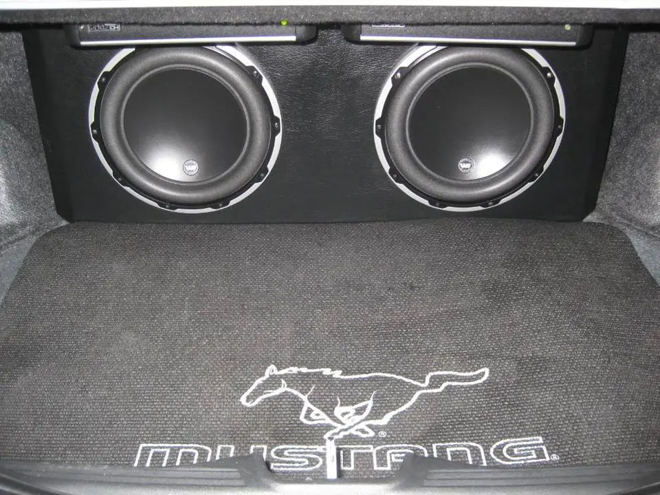

I did this in my 02, had the mach 1000, sucks. I took a piece of luane plywood and traced the plastic speakers box, amp holder, and wraped it in carpet. Used a couple of black interior screws to hold it up. Turned out real nice. I then put 6 1/2" comps in the rear deck, made adapters out of aluminum flashing, worked out real nice and is a huge improvement over stock. Also did it in my sons 95 gt.

That looks pretty good. Mine right now is a bit more cheaply done but still is adequate for me. I believe the speakers will be fine without the huge ass mach stuff, mine is. Might double check and call Crutchfield and tell them what you have and your concern and I would be willing to bet they know the answer.
