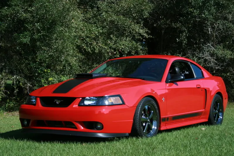

The Mach chin will fit nicely on your front end. I've thought about a chin too but I already come within centimeters of curbs and speed bumps with the 01 front. Im sure that I'd rip the chin spoiler off in no-time.

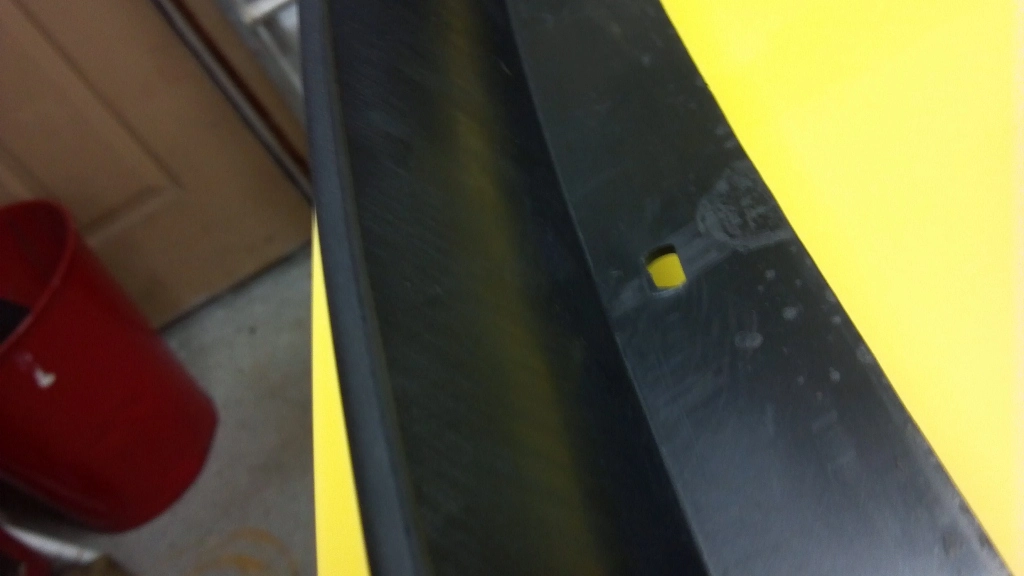

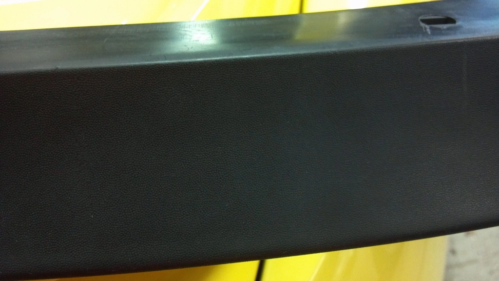

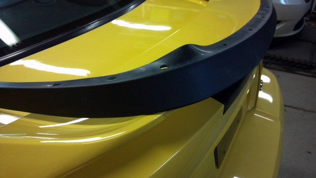

yes I bought the SVE version. I can get some pics prob Fri night or def Sat after work. As far as quality, I did put one on my old 04 back in 04, but I cant remember any differences honestly. It seems the same. It is rigid, but it has been sitting in a cold ass garage since Dec.. It has a textured finish and came with the pins to mount it. They def. fold it up good in the box. So I need a nice hot day. I'll post pics of the lowered car and the spoiler. I won't post any now with the new rims cause well you all know it looks like a 4wd lol.

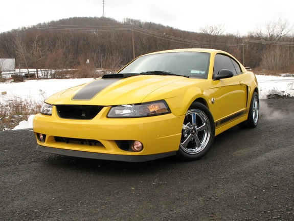

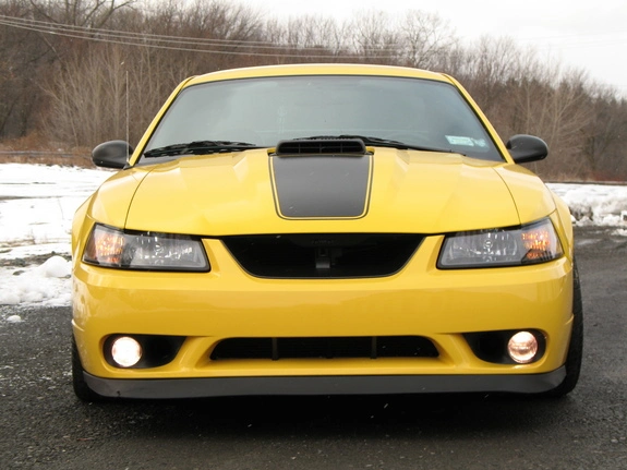

Here's mine. It's an '01 Cobra bumper with the mach chin spoiler.
Fit was good. Just had to bolt it on alittle more securely than the provided hardware. Was the only issue? I jacked the front up an drilled holes in the underside of the bumper an used bolts with fenderwashers to secure it on the bumper.
Sucks they actually folded it to ship it. Mine came in a tall box. I would've been pissed if I actually paid hundred something for it an got it folded in half.
