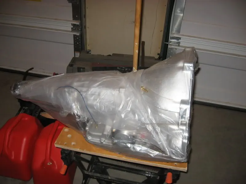

Ya I can't wait to get the C6 in there. I love 5 speed cars for racing but this thing just blows the tires away all the time. The auto should settle it down a little. My crappy suspension doesn't help either. Now that I've got the power I have to build the rest of the car around it.
Should be a beast when you get that boost going! I'm running a C6 on my 408w setup also, just blew it up too... I just bought an ATI trans brake for mine, which brake do you have on yours?
I don't know to be honest with you. It's sitting out in my garage. A friend of mine owns a race shop and builds these trannys. He's running one in his car and it runs 7.9's all day long. That's who I got to build mine. I just see the wire hanging out of the tranny case waiting to be hooked up. I still have the tranny in the protective plastc.

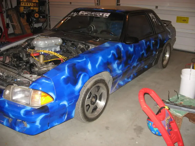

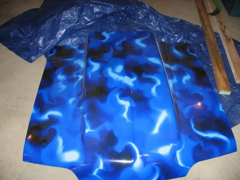

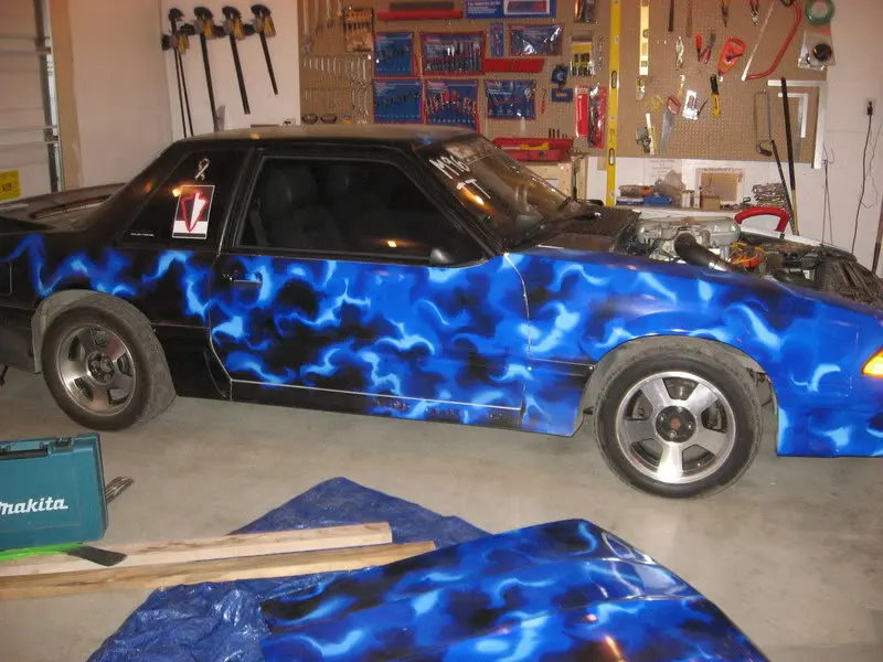

Here's just some shots of the car now that it's home. I still like the vinyl job though. Just can't get the hood to fit. CIA is too big because of the throttle body. I don't want to butcher the hood until I get the new T-body on it. Had to race without it. Kinda looked a little hillbillyish but had to see what she would do and break her in.
