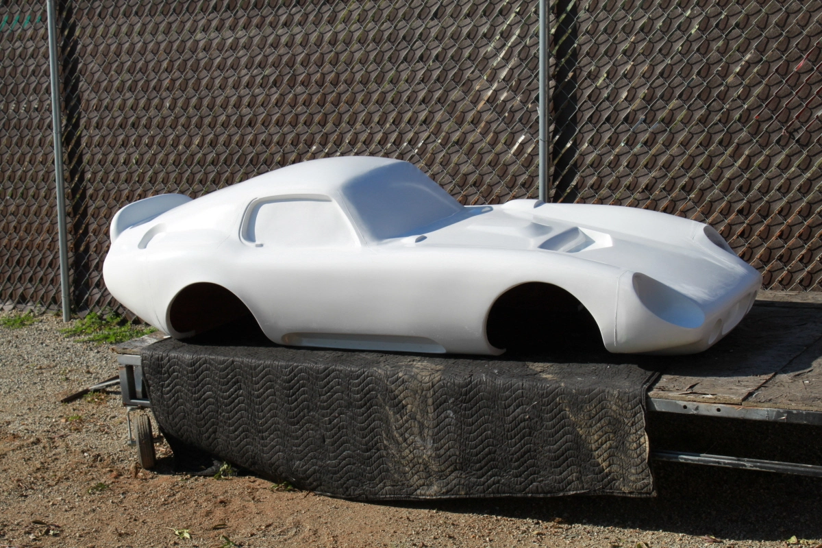

it is amazing what can be made on those cnc machines. we had a foam 3/4 scale
daytona carved out at a cost of $3,000 ,then had a mold made and this one and only body made, it is 8 feet long

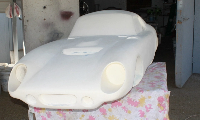

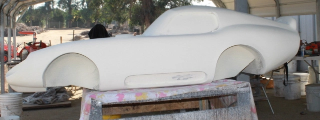

i didnt get to see the foam part being made but the guy said it is cool to watch.
he said he could make it a lot more detailed but it would take a whole lot longer.the guy i went in with on it bioched and moaned about the lack of some of the detail but i thought it was fantastic job and i would do it the same way again. this is the foam part.
That is the coolest thing I've seen in a long time. I'm a huge fan of the Daytona Cobras ( my screen saver is a shot of one) and I would give anything to see that foam core being cut. What was the final product used for? Whatever it was, I'll bet it turned out well. Very cool indeed.
