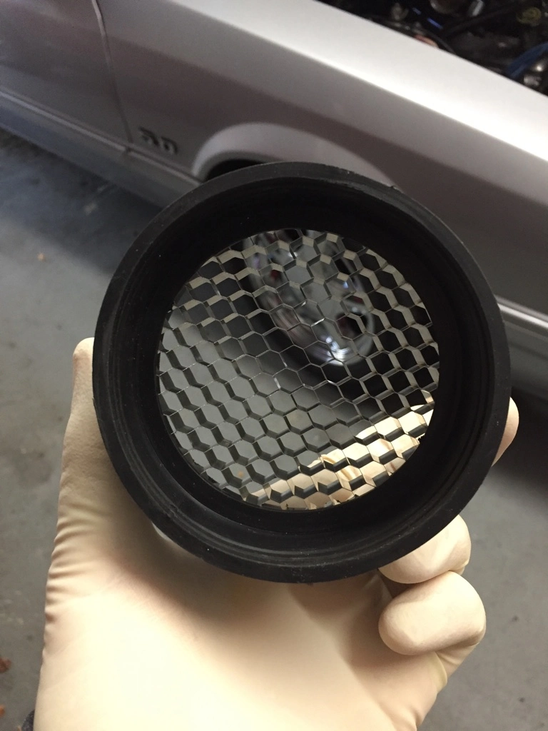

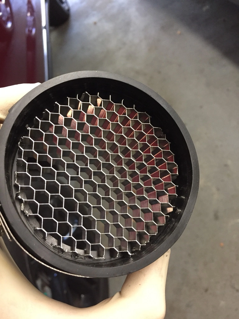

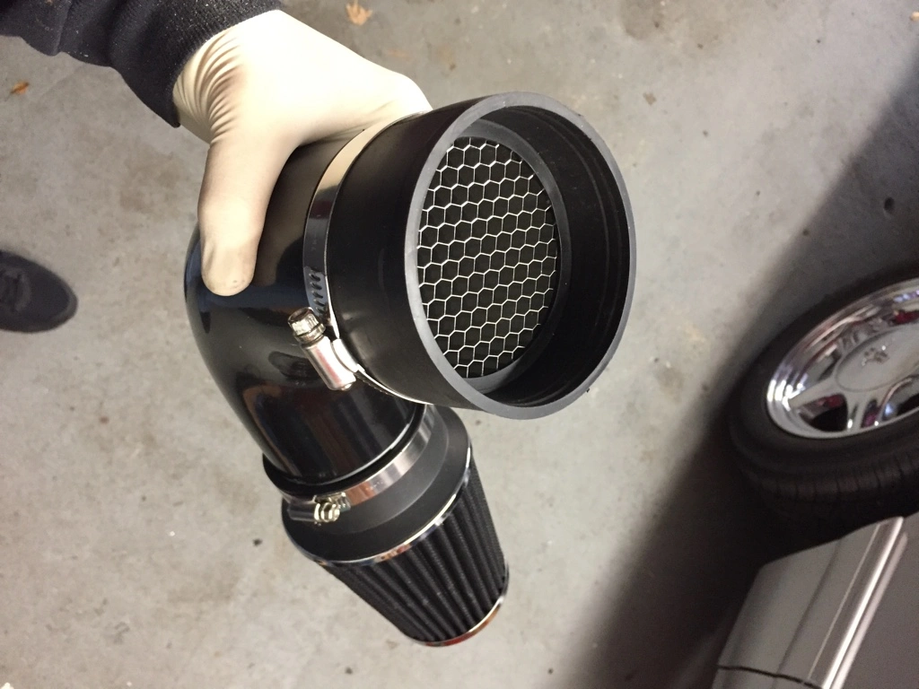

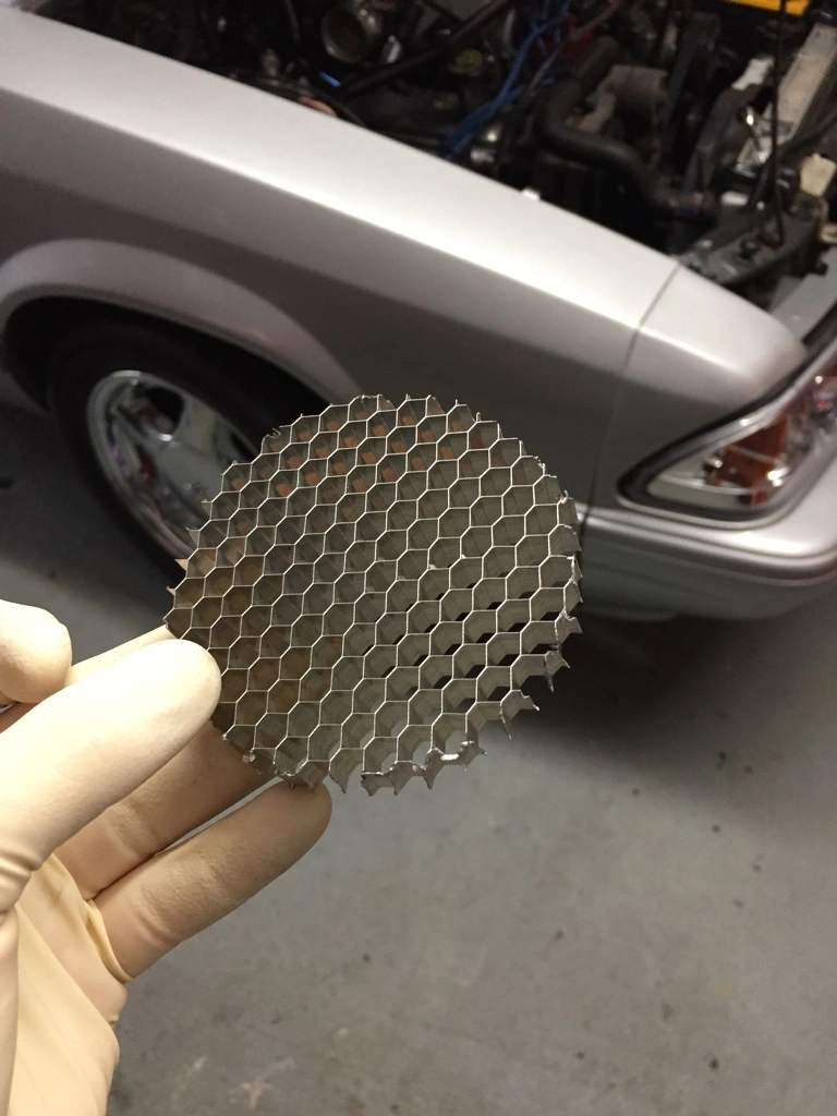

Just thought I would share a MOD I do with MAF cars that have a bend in the intake just before the MAF.
Many say to just click the MAF but that to me is a bandaid. My 2014 TT car has issues with air turbulence and after this mod the car ran great and the tuner said the MAF was way happier.
Basically this smooths out air flow and keys the MAF so it's job better.

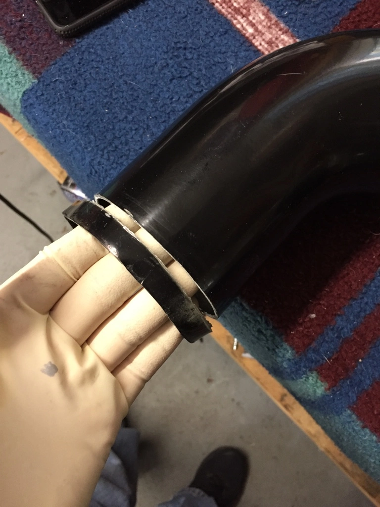

I ordered my straightener off back for like $24. You should measure before you buy but I was out of town and went ahead and got a 4" one knowing I could cut it down. I'm running a LMR cold air kit thru the fender. If you have this kit you need a 3.25" screen. If you put the screen in the rubber piece you will need to cut 1/2" off the tube.

Follow up to this "mod". My car does not like it as all. Bucks like crazy while in the lower RPM range. Guess the MAF just likes crappy air.
Sent from my iPhone using Tapatalk
What's your air filter set up. Like stated earlier you need straight pipe before the maf and don't hook the filter directly to the sensor.
Late model CAI kit thru the fender. The whole point of the screen is to straiten the air after the bend so the MAF gets nice strait and smooth air.
This worked great on my 2014 TT car. Just not on this car. Pulled the screen out and no more bucking. Never needed the screen but i waned to see if it would smooth out how the car ran overall. So overall experiment was a failure.
