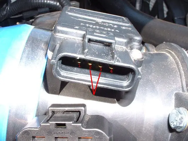

Hi,
I'm hoping someone can help me with a prob I'm having...I'm trying to figure out if there is something wrong with my MAF. In my Haynes manual, it has some guidelines for testing it with a multimeter. According to the manual, the pins on the MAF (as numbered in the attached pic) are pin 1 is REF, pin 2 is SIG, pin 3 is GND, and pin 4 is B+V (batt). In the manual it says to test the resistance between pin 2 and 3, and if it is infinite resistance then you have a bad MAF, however, when I tested pin 2 and 3 I got 0 ohms of resistance! Maybe this is normal, but it seems strange to me that SIG and GND would at least seem to be shorted. Could one of you pull out your multimeter and test pin 2 and 3 on your MAF and let me know if there is 0 resistance between them? It would be a great help because I can't seem to find the answer! :shrug:

Don't know if this is any help mine looked like it had 6 wires. I checked it (was raining didn't pull MAF out) I got 0.2 ohm reading.
Did you check the pins on the MAF or on the wiring harness that is plugged into it? The harness has six holes but only the middle 4 are used, the MAF I think should only have 4 pins on it (?). If you tested the 2 pins I did, .2 ohms is pretty close to 0 so it probably is normal... :nonono:
Thanks for checking... I guess I better keep looking for my problem... :bang:

I checked with it unplugged. Since it was raining I didn't pull MAF out to look inside I only got one res. reading where #2 and #3 should be.
Kilgore Trout said:
Newer MAFs incorporate the IAC in them and all six wires are used. Older ones do not and only use four. Not sure but I think it changed in 2003...
I see... Maybe BooWFO tested two different pins than I did? Hmm.... On the 6 pin MAFs I wouldn't know which one is ground and which one is SIG. I wonder if my local parts store will let me test one of their new ones without buying it lol. How much are MAFs anyways? Aren't they expensive?

four inside pins are the same I believe. the two pins on the outside are part of the IAC on 02s and up.
