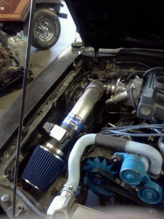

What if someone was to have a cold air calibrated meter, but actually not have the cold air intake go into the fender?
Here's what I'm running, and I figured I had to order a MAF calibrated for cold air since I wasn't using the stock air box. I used to get an occasional pop out of the exhaust when running and I remedied that by upping the fuel pressure. I had to go to like 43-44 PSI to get the popping to go away, but I get an occasional pop still. Would the filter not being in the fender cause this occasional pop?
