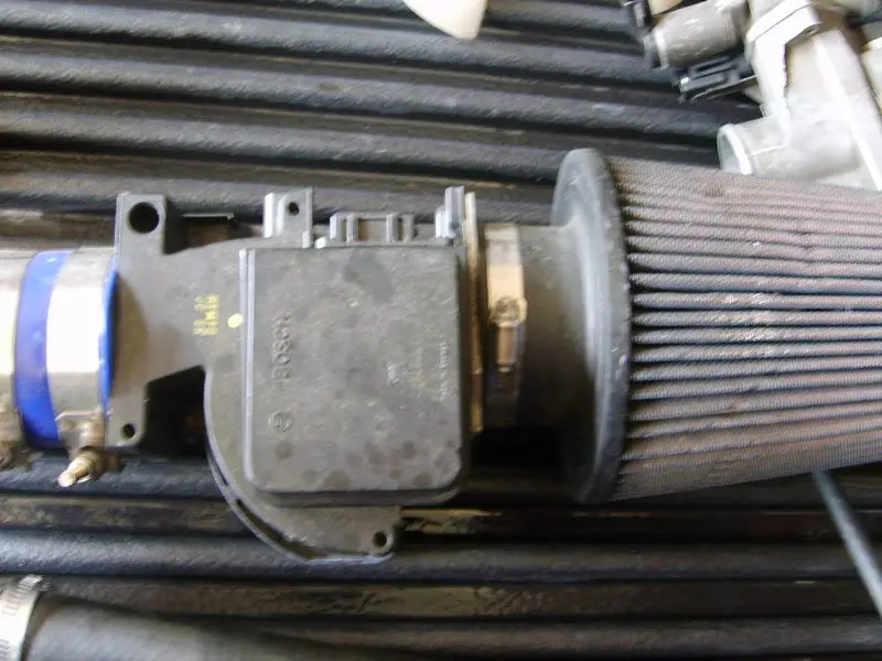

Okay a picture is worth a thousand words right?
Here's a thousand for ya. This is a VAM
