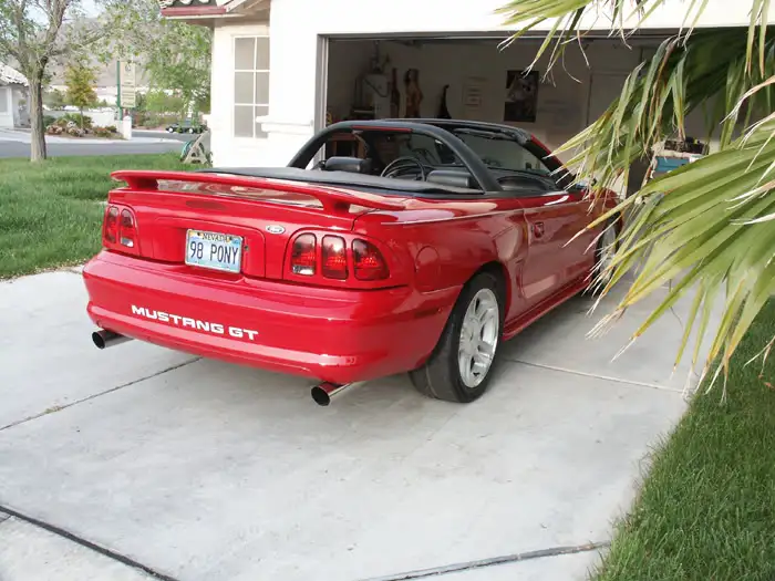

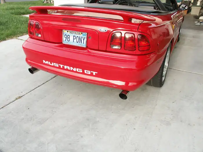

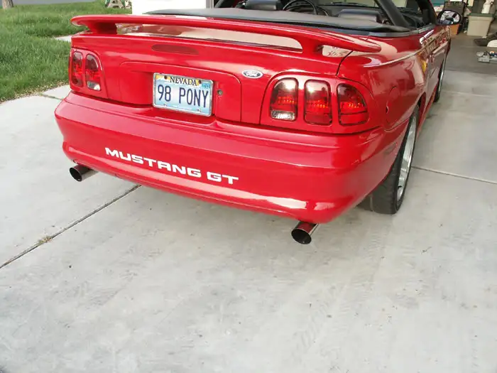

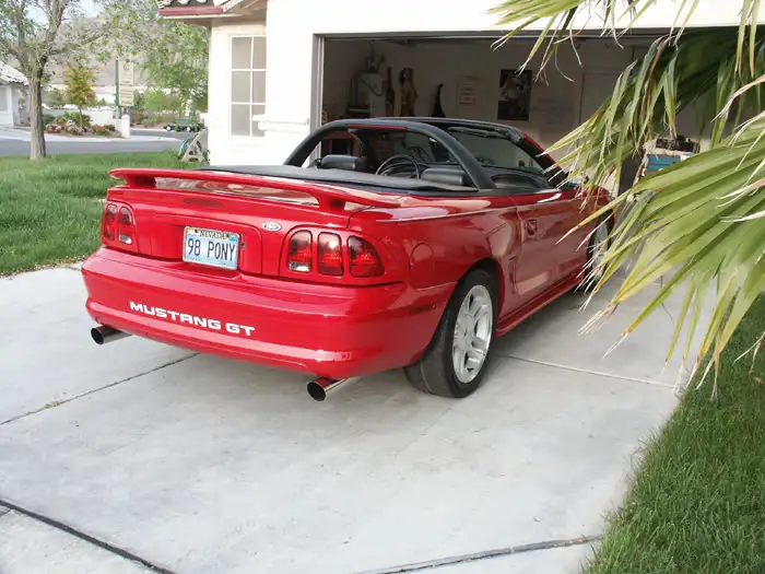

Pennywise2 said:
GDawg would you be as kind enough to post some pics of the
Magnaflow Magnapack catback on your car so,we can see what
it looks like from the back of your car? Thanks.
I don't have any pictures of underneath.
Thanks for the pics GDawg! :nice:
Those 3 1/2" tips look bigger in person than they do in a picture.
