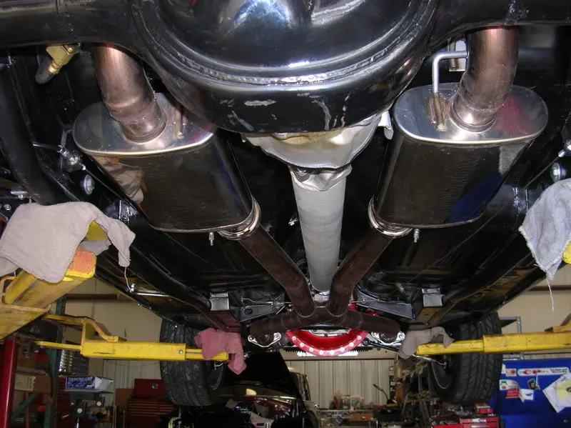

I am finally in the midst of installing my 2.5" magnaflow exhaust. Does anybody have any pointers or pictures for the muffler bracket install? From what I remember the Flowmaster system had specific measurements for their bracket, but Magnaflow just shows a general picture on the instructions. Just get it as high as possible to keep the muffler a 1/2" or so from the floor?
I used existing muffler hanger screw holes. The top of the hanger plate is even with the top of the rear seat belt bolt.
