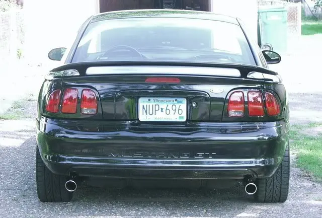

Get the magnapacks. I've had the Magnaflow catted x-pipe and magnapack catback on my car for about 6 years now and could not be happier.
My friends cannot hear their cars over mine if I go WOT in front of them on the highway.
They have a nice grunt down low, but don't sound hollow and up top they scream unlike anything else.
Oh and they're 50-state legal last I checked. I've passed inspection here in NJ without any problems, over and over again.
