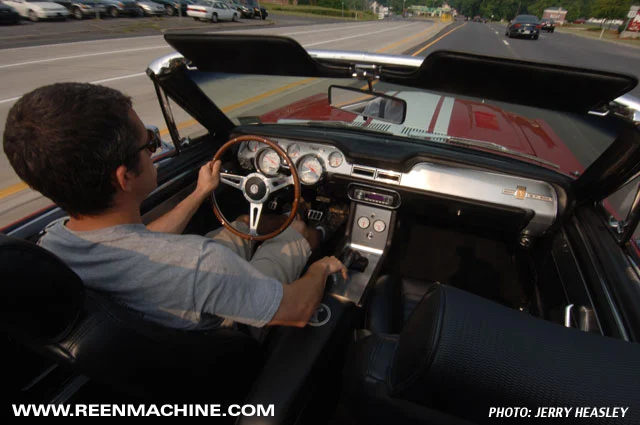

Here's a driving shot in the 'vert to show the shifter positioning. This is the lower non-console version since the Shelby-style console sits basically at floor level.

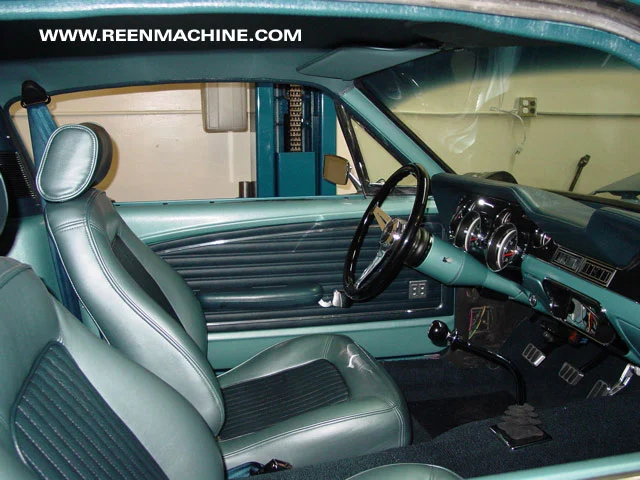

Here's that shifter for a comparison. It looks like the stock-appearing one puts the knob higher up and maybe about the same amount back.I have a T5 with one of the repro stock looking shifter levers with a stock 67 center console. How much farther back towards the driver do you think your new shifter will place the shift knob?

EDIT: it's in 1st gear in the photo, so maybe they're about the same.
That looks pretty comfortable as far as cruising goes, and really, that's all I'll be doing probably.
Yeah, it's real comfortable with the armrest in the 'vert. The knob is right at your fingertips when your arm is in its normal position on the armrest.

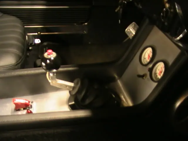

I gotta say, if you can knock those out for under $100 and still make any sort of profit at all, you must be doing something right! I'm a CNC machinist and I can at least three operations in that part, plus aluminum prices have skyrocketed since January, not to mention the anodizing process isn't free, either. The only change I would make would be smoother corners at the bends, but other than that, they look great. Also, I'm assuming the holes on either side of your logo are used by the machinist to hold the part to a fixture, I'd either add a couple more per end to make them look like they belong or ask the machinist to lose them altogether, and hold it some other way.

Those are indeed tooling holes, and they won't be there on the production version -- we're securing the part by one of the mounting holes and a sacrificial tab with a tooling hole that will be cut away when the threads are cut.

I have the aftermarket console with a short shifter and I have to lean/reach to hit 3 & 5. Also the boot sometime bumps it out of 2 & 4.
And i like the holes, as it gives me a place to wire tie the NOS wire (not tied in the picture).

I'm pretty sure the final version won't have the holes, but you can always drill one.
