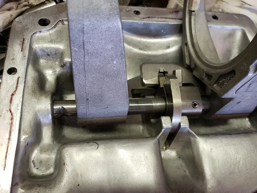

So I'm trying to assembly my T-5. I went to a ton of trouble to make my manual neutral safety switch work in a car that had been an automatic. Everything is good, including the switch itself. I tested the switch with an ohmmeter today. It's closed when out and open when in. But when you install it in the transmission, it's always in for some reason. No matter what gear it's in. Why would that be? The little pin is in there, and when you move the shifter, I can feel something happening at the pin, but it never goes in or out. Please help!

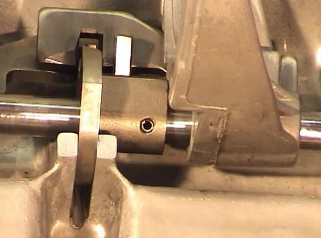

A friend lent me a Badshoe T-5 video, and it actually has how to do this!
All you need to do is, knock this roll pin out of this teardrop piece, turn the shaft over, and reinstall it!
Not so bad!
Yes, it's pretty easy. Before you go that far, you should be able to pull the shaft back far enough to see the tip and verify that it is, in fact, installed upside down.

Today I took it all back apart, and sure enough, there's the shaft, upside down.
Drove the roll pin out, got the roll pin punch stuck in the shaft (everything can't go right, can it?), turned the shaft over, and drove it back in. I mocked up the cover, and tested the neutral safety switch, and we're all good. It's now closed in neutral and open in gear. Question answered.
