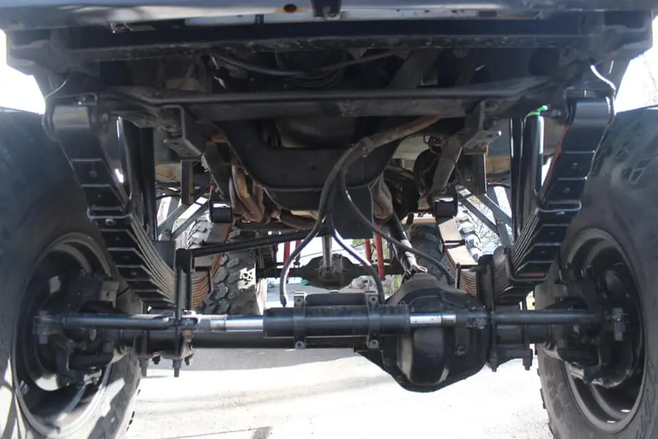

When put in a Jeep the T5 isnt sitting very level especially when theres a lift kit and your trying to keep driveline angle not so steep which is wrong..
When you have to do that you need whats called a dropped transfer case and or somebody who can change the angle on the rear and front axles..
When a stickshift transmission isnt mounted level front to back and mounted dead straight to the rearend they develop noises and shift problems as the gears are trying to sideload on the shaft towards the lower end of the angle plus it makes the fluid ride more at the tailshaft too...

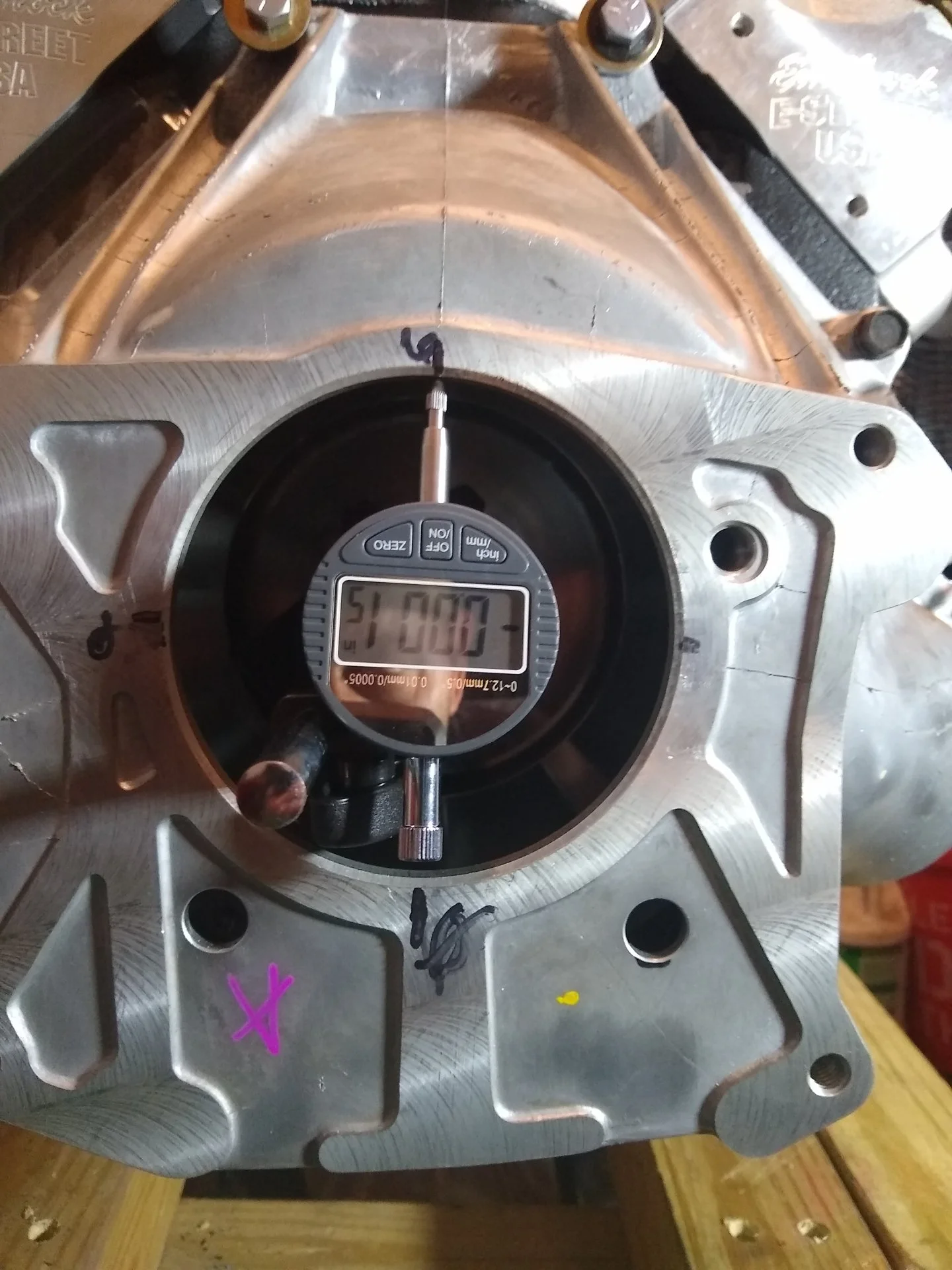

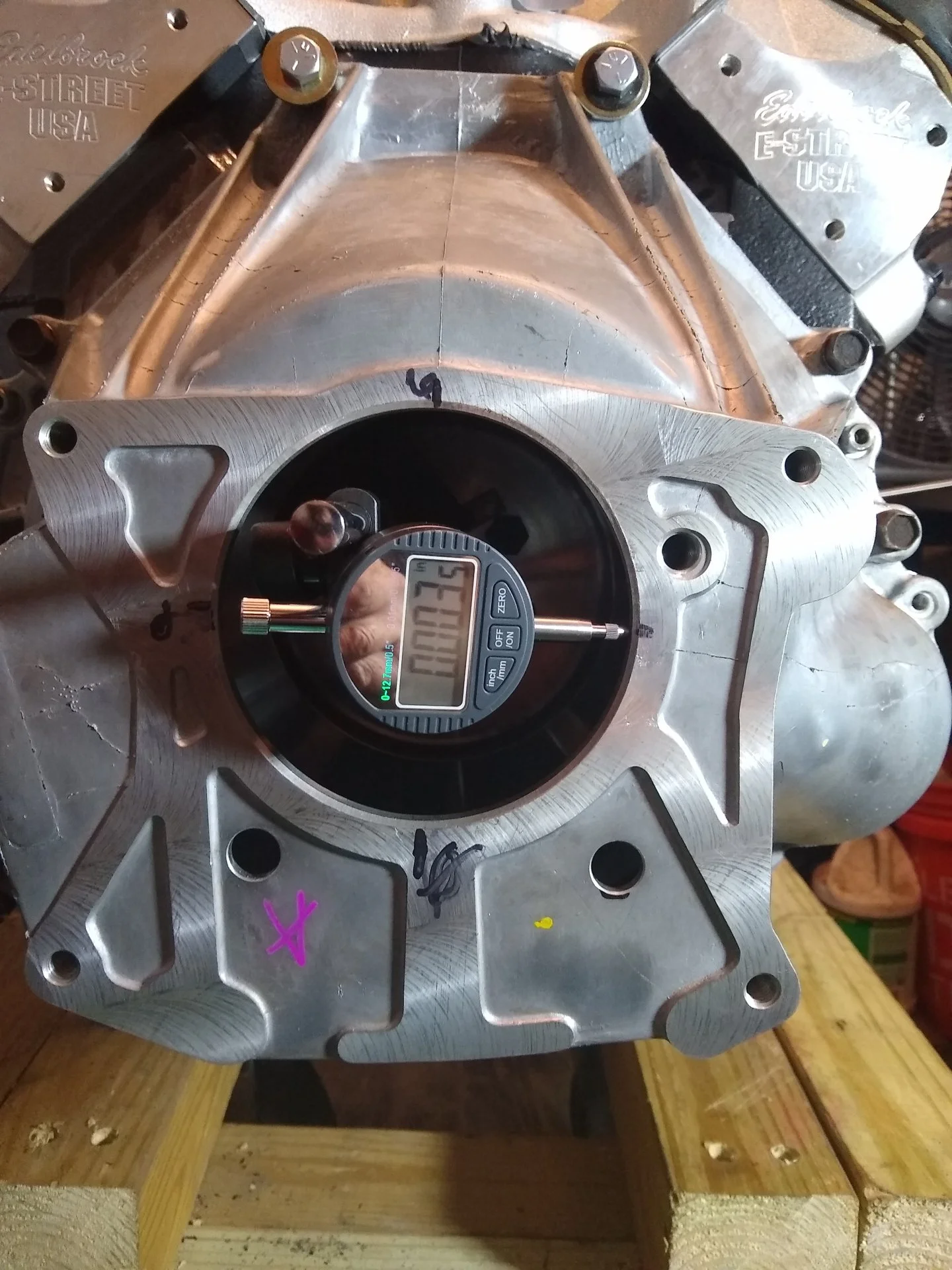

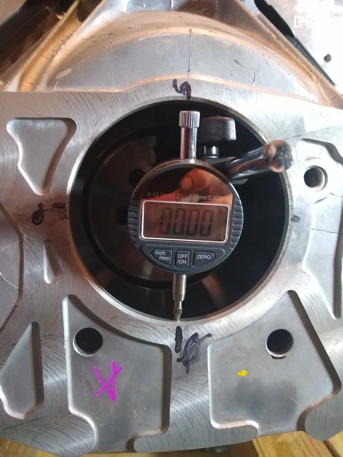

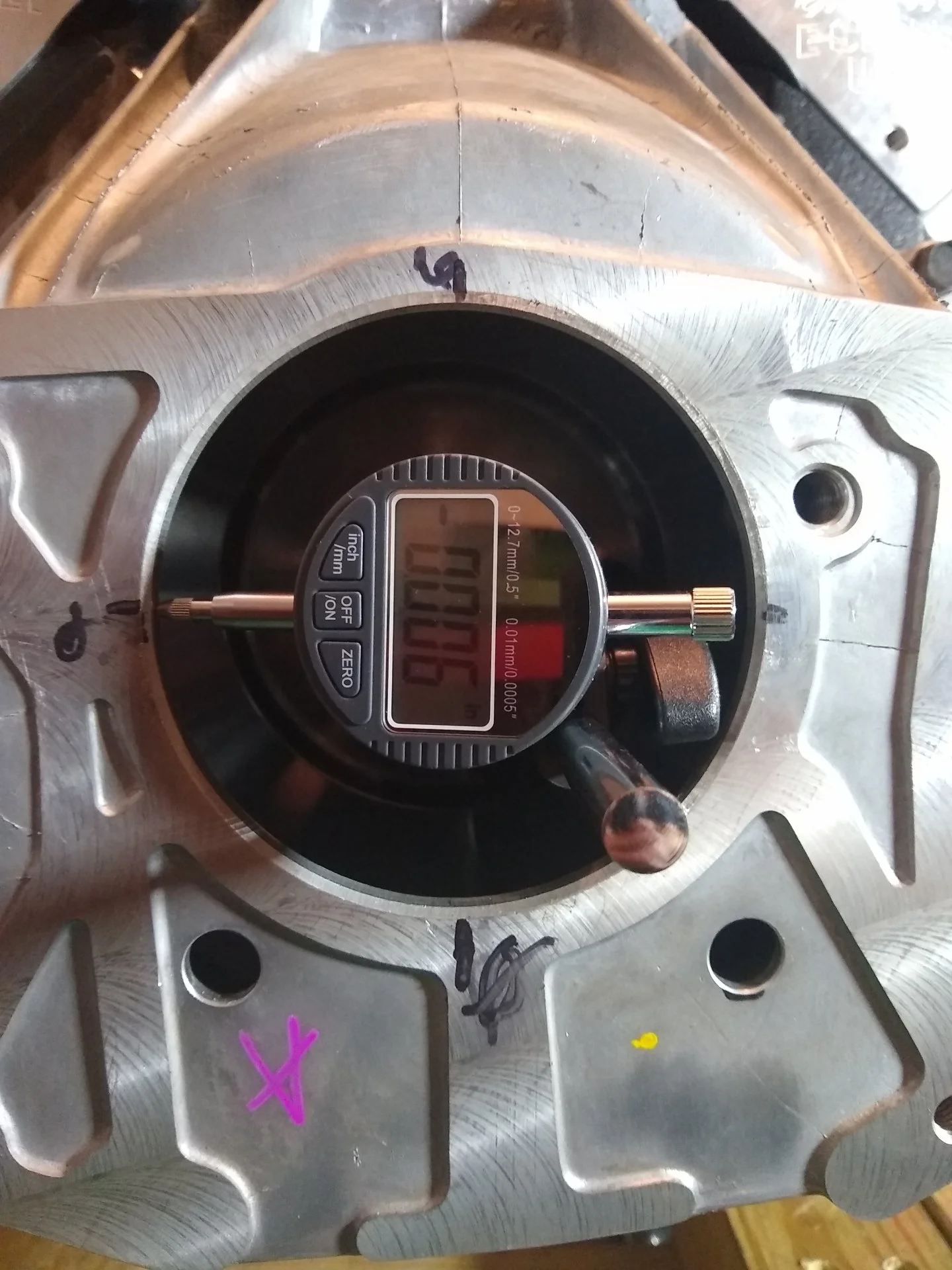

Another thing is making sure your crankshaft centerline is properly aligned to the center of the bellhousing hole using a dial indicator and correcting it using offset dowel pins...Industry standard is .010" TIR but I shoot for .005" and under........
I like the offset dowels from Robb MC..They have a setscrew that holds the pin in place so when a clutch needs to be done the setting isnt disturbed when the bellhousing is removed..

I have never put a dial indicator on a stock T5 bell housing but maybe I should...dunno. Have not had an issue on my Coupe or the SROD bellhousing with the TKO in the Bird. I know you need to on the Lakewood and McLeod bell housings and most require some offset.
