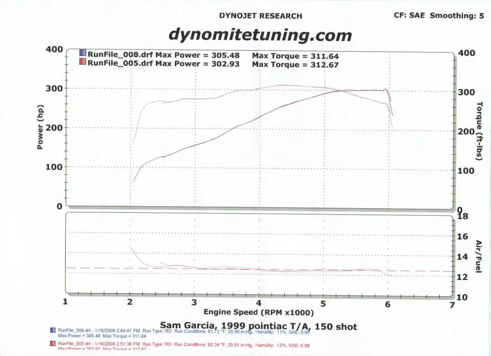

I am running Bamachips 91 race tune and I added 1% fuel at both below 2k and above 2K. Prior to adding the fuel my car dynoed 298RWHP/308RWTQ. The A/F was right around 13.5 and the the temp was 75-76 degrees. After adding the 1% fuel, on the same dyno, but a different day, the avg of two dynos was 303RWHP/312RWTQ. The A/F was around 12.3-12.4 and the temp as 82 degrees.
Here is the dyno sheet . Disregard the title of the says. Someone who was hanging out at the shop was showing my a dyno run of some T/A.
