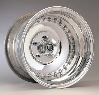

how do you guys think centerline drag wheels would look with the center painted black 15x9
i'm looking for a set of drag wheels that are streetable, and i don't know how i'd like that style. i really like bogart/ fr500cjs, but i dont want to pay 1600 for wheels i can drive once and a while on.
i love prostars. but i'm trying to see if i can find something unique.

Might be cool, but they won't fit.
Greg Weld has some just about to release (finally). Otherwise, custom Bogarts or Centerlines are your only options, unless you can find some used Weld XP's. All other wheels will not clear the brakes. And all 15" options will require you to relocate your rear sway bar.
what brakes would i have to worry about? front or back? i was going to run a 3/8 spacer in front, and whatever is required out back. and i'm gunna relocate the swaybar.
and those are centerlines. at least thats how they were labeled.

Are those custom? They have to be custom made for S197s. Anything off the shelf will not work, except for the Weld XPs that I mentioned (that are discontinued).
The rear brakes is where you will have a problem. Even with some serious grinding of the brakes, they most likely won't fit. Believe me. Just about every "off the shelf" wheel has been tried, and none will work without serious modification.
