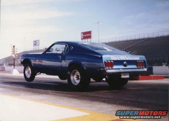

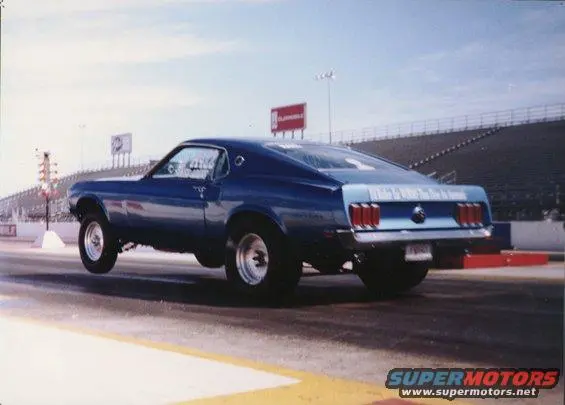

The tranny in question was a Jerico 4-speed in a 3000# '69 Mach I with a N/A 289 w/ '69 351w heads and a Offy 360 Tunnel Ram with a pair of 660 center squirters and 5.67 rear gears on 9x30 slicks. Ladder bars and coil overs. Ran a best of 11.08 @ 119. All old school.
