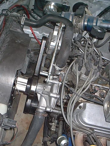

Seems like the March A/C delete would work best for you. Here's a pic of my old car when I had that kit.
attachment.php
Dip In Traffic - Although other companies probably carry them, I got my March alt. bracket kit from Holcomb Motorsports in Lumberton N.C. for $59.99. It is part # MP 1465
Here's a pic of another angle. Like I said, it has worked great for me. A friend of mine has the exact same Alt. setup on his monster race engine and it has worked fine for him too.
attachment.php
