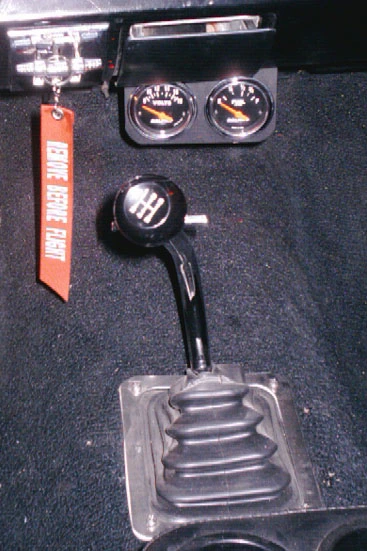

Here's a pic of the 0178 stick in first gear:

As far as reach, it's perfect for me. I'm 6 foot, pretty average length arms and it's a full arm's length for fifth only. I love my setup now, only thing to make it more fun would be more supportive seats for cornering.
Keep in mind that you can also either a) modify and existing one to give you the curves you need, or b) make your own. When I did my 6 speed swap the short stich that came with it wouldn't work. So, I contacted Long Shifters to see what else they had, none of them would really work. I bought one that had the backward bend I needed but it angled to the wrong side. I heated it and slowly bent it to the angle I needed. If that won't work you can make one/have one made fairly easily. Especially if you are going to use a full shift boot like BobMarley has pictured in his second pic
