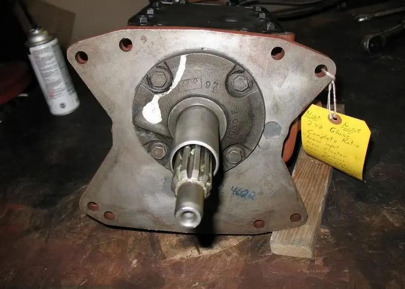

Just stay away from the early toploader made with a 25 spline output shaft (pre-1965) and you will be fine. Luckily these are fairly rare.
With the Cleveland, you will want to find a toploader with the small block type input shaft. It is longer than the big block input shaft. Here is a pic showing the difference:
Also, you want the later style case too. Available from mid-1965 on. It has the proper bolt pattern for you bellhousing. Basically, it has wider mounting ears and a dual bolt pattern, such as seen in this pic:
