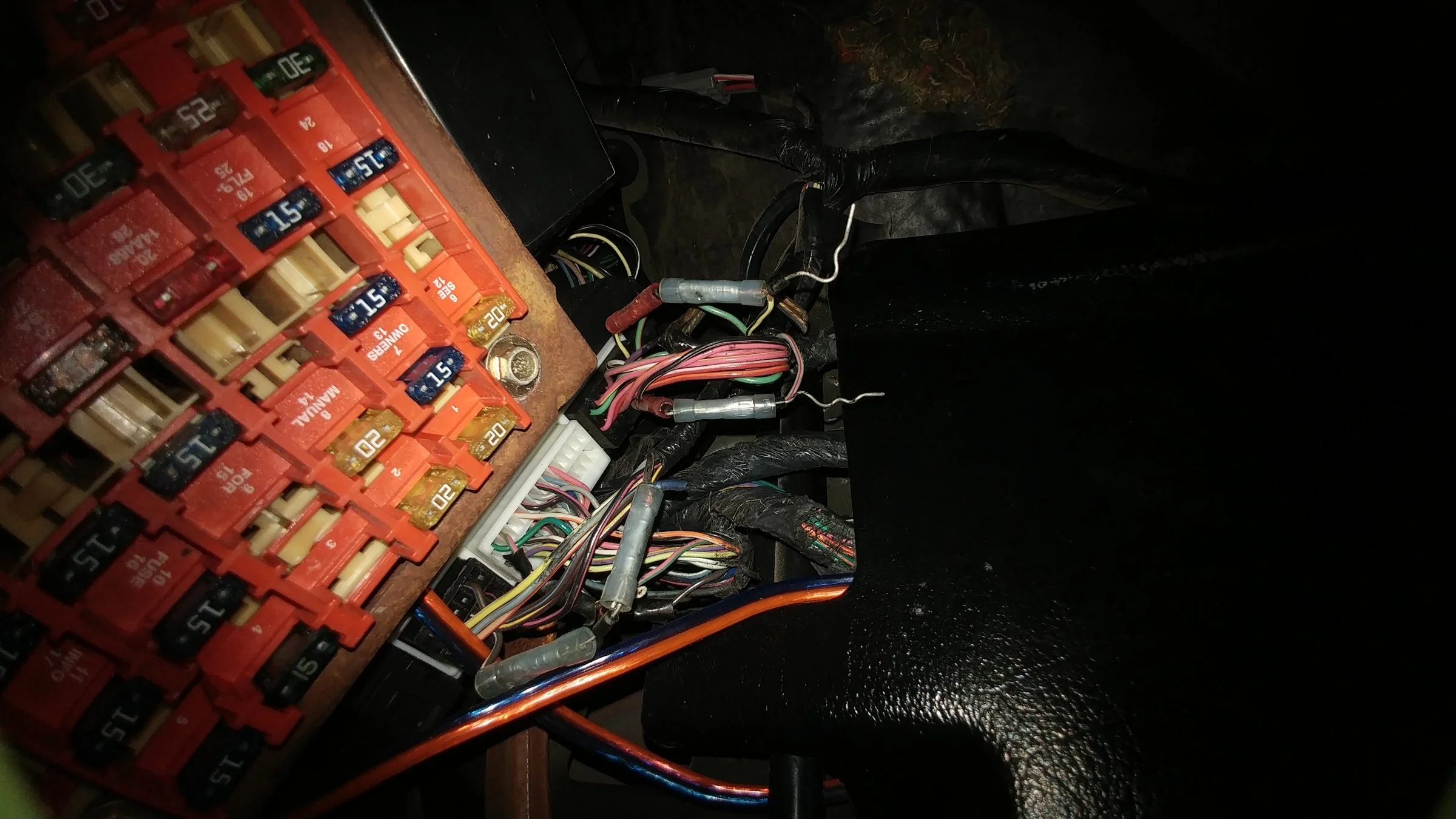

Saw this too. Diodes spliced into wires...looks like they used to be tied together or to something else. Location is to left of the fuse panel in the left kick panel
