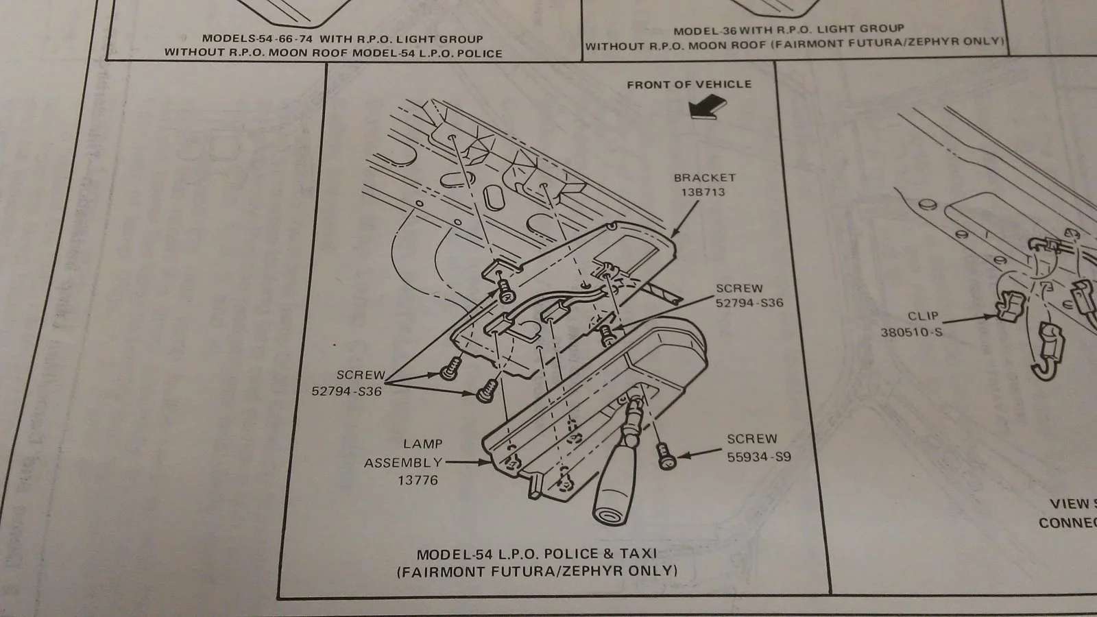

Map light version used in my car (from Ford manual): Picture matches what I have even though the vehicle application doesn’t include the Mustang or Capri

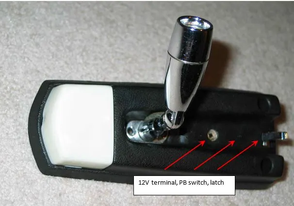

Mine looks like this one (found at ascmclarencoupe.com):

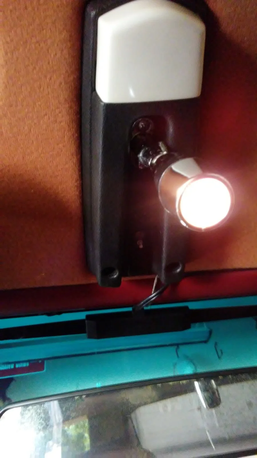

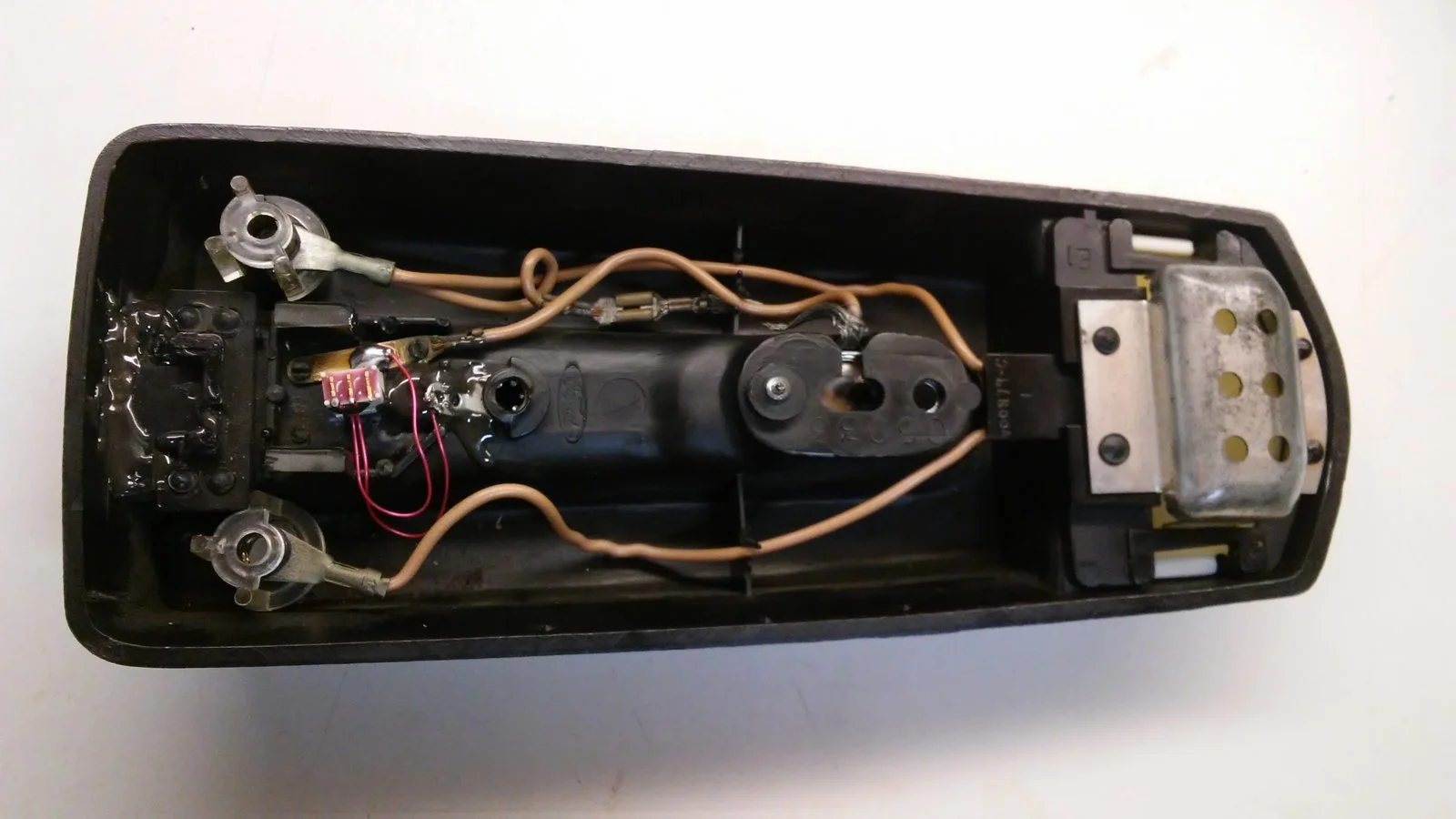

Since the housing supporting the latch was shot, I decided to use a magnetic latch. I’ve got a good collection of small magnets and attached the magnets (using JB Qwik) to the light and housing (between the PB switch and 12V terminal). I found a normally closed PB switch from Digikey (C&K EP12SD1SA1BE) which was a good replacement.
It isn’t the most elegant solution but works. I need to take it for a spin to see how well the magnets hold after going over bumps.
