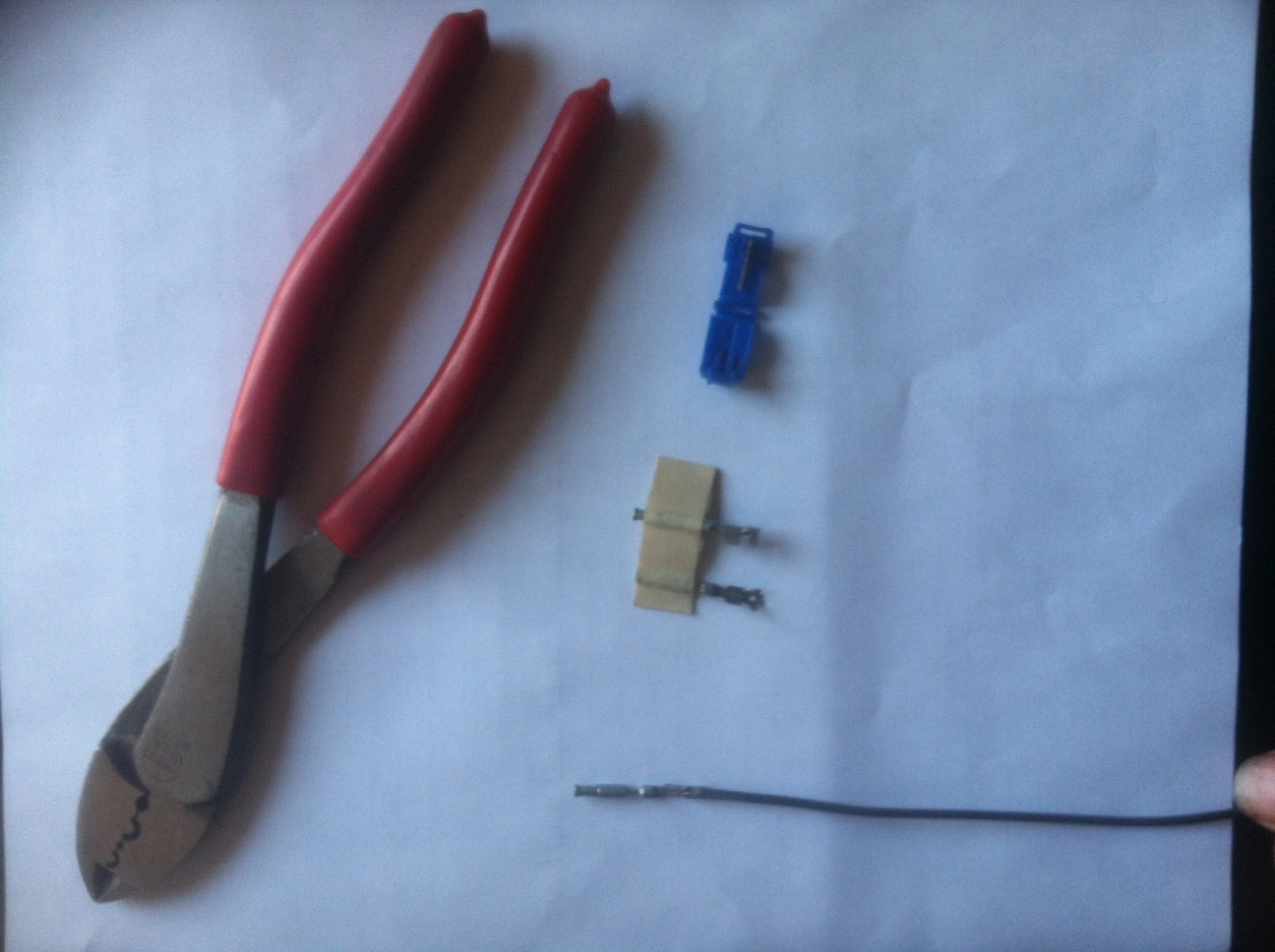

Since there has been a lot of inquiry about Mass Air Conversions I thought that I would help out. The following information will help you wire in a Mass Air Pigtail into existing harness allowing for just a simple computer change after installation. This installation can be performed in about 30 minutes depending on how knowledgeable you are with Fox Body wiring and how you choose to route your wires and with just the items in the pictures.
