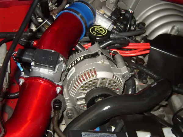

the maf sensor is removable from the plastic housing its within just remove the plastic housing and pull housing apart by unlocking the plastic tabs with a screwdriver then remove the 4 bolts holding the sensor inside the housing if you look at the pic. i posted below you can see two of the plastic locking tabs i'm talking about its fairly easy to remove once you get started...you will have to buy an aftermarket cold air intake and the maf will fit into it as in the pic below of mine. i think K&N also makes an adapter and cone filter that will bolt to maf if you want to run the original rubber air tube. i bought this cold air intake off e-bay for about $25...ensure you clean the maf sensor before installing i cleaned mine as stated in this link.... http://www.muscularmustangs.com/maintain.php

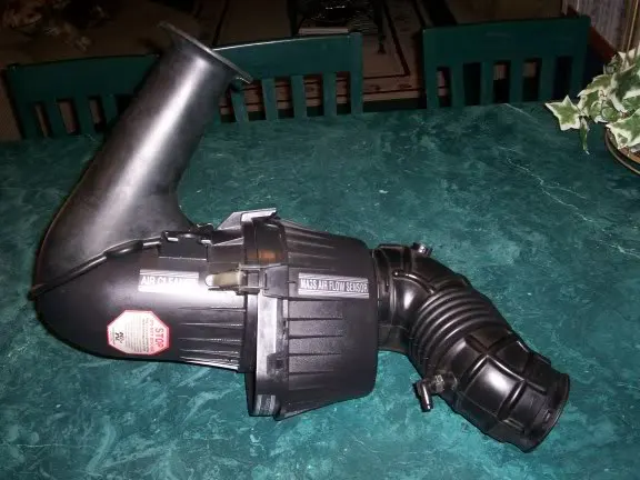

picture of my old housing with the maf removed which i sold to an individual for $30 who wanted a stock replacement for his stang which had one that was cracked...if you look approx. 3 inches below the metal locking clip you will see the plastic tab that you will use a screwdriver to pry up on to pull housing apart to expose maf sensor theres also one tab on the top and one on the backside.

ok so if i take it out i cant use the factory plastic elbow then...i wanted to do a cheap filter upgrade for now as my attention was else where and i need to replace the filter...i wanted to use the tube from the tb to the maf and the k&n in front of that....maybe i will look on ebay...i want the least bling i can get tho no chrome or none of that...
