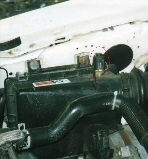

I had a c&l on my old 90 with that garbage ass march ram air kit. It would run rich and and spark knock with anything less the 93 octane and in the winter it would spark knock all the time. After some playing around i used the stock air box with just the scoop for the ram air and it helped alot in the summer but it would always spark knock in the winter. A friend of mine That use to ru NMRA Factory stock class told me a little trick he used to do when he would steet race. He moved my air temp sensor off the intake and installed it on my stock air box. We also changed plugs, wires, cap and rotor and left the timing where it was. After that i never had a spark knock problem again. His thinking was now the computer can see the true air temp coming in from the air cleaner and not from the hot lower intake. I can not and will not say thats what fixed my problem but i never had a problem after that. Also i put 80,000 miles on that engine with no problems.
Here's a pic of what we did.

IIRC,
The ecu PULLS timing with higher ACT temps....
Lower ACT temps would have meant more timing....
Also, the stock computer is calibrated with the stock ACT location in mind.
Moving it means the stock tune is no longer as 'correct' for lack of a better word.
Not sure what fixed your problem, but I'm hesitant to think it was moving the ACT...

I too have read and heard that moving the act does nothing since the computer is tuned to work with in in the intake, the only, or main reason people move them is so they can install an intake that is not set up for an act sensor.
