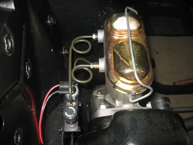

When I converted my 68' from manual drum to manual front disc I was working at a parts store and searched through the specs on a bunch of master cylinders. I settled on one from an 83' Ford Ranger 2.3L 4x4, with manual brakes. It is aluminum with a 15/16" bore and the ports face away from the engine just like the original.
