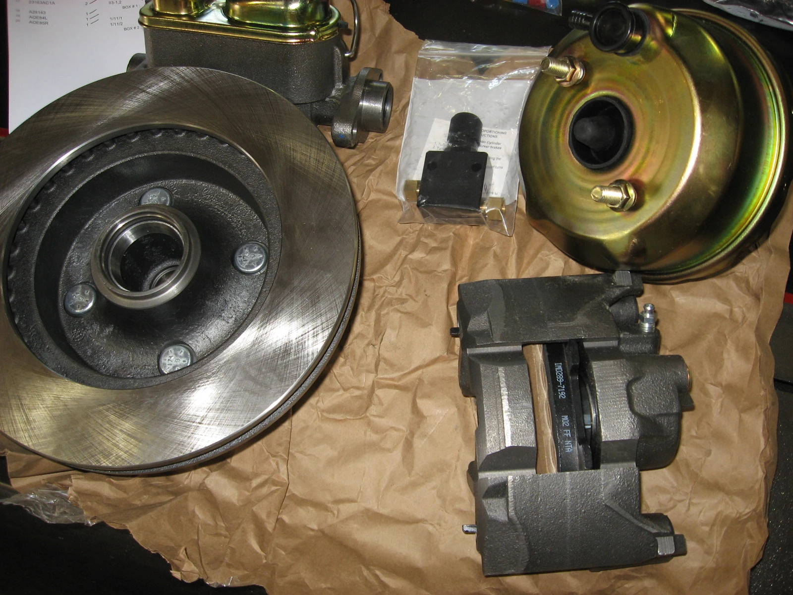

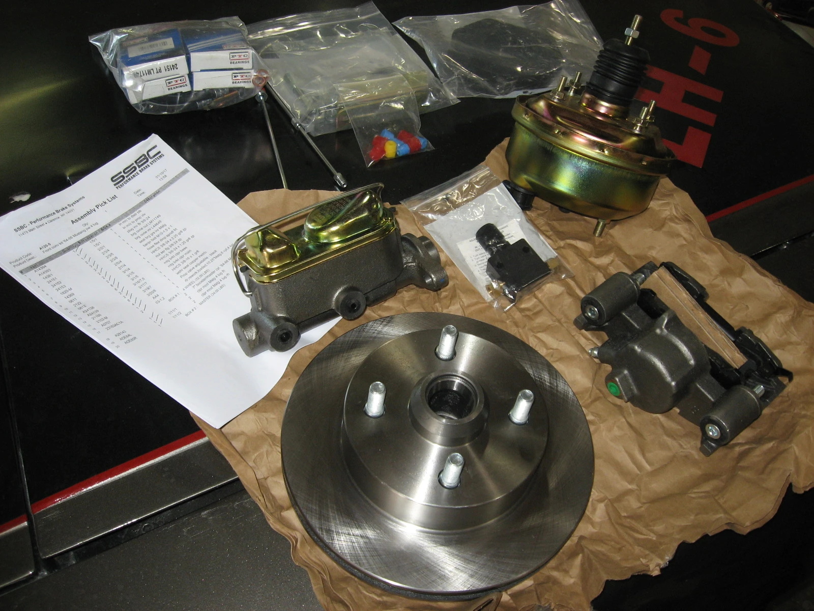

The Summit kit (drum front to disc) has a 7" diameter booster that will fit with the dual chamber master in the kit. Mine is a SIX with automatic and Monte Carlo bar/export brace. The booster is not needed in my case, but I know it works because several guys have installed the complete kit.
