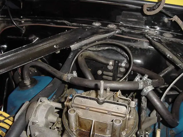

Spot the problem with my brakes
Well, as you can see the problem with the brakes wasn't any thing really technical, it just pays to look at the simple things first:rlaugh: One of the previous owners for reasons known only to him self disconnected the crank case vent hose from the carb, plugged the carb off and reconnected the hose to the vacuum manifold where all the vacuum hoses are fitted and the the guy who fitted the disc conversion, teed into the same hose for the booster, so most of the vacuum pressure was going back into the crank case cover. I am a little embarrassed to say how long it has taken to find such a simple fault, so much for putting your faith in the so called experts.
